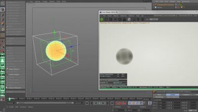

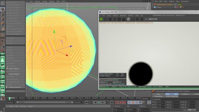

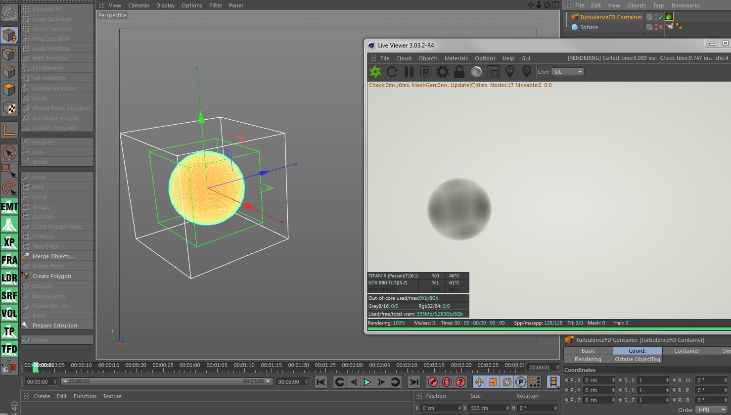

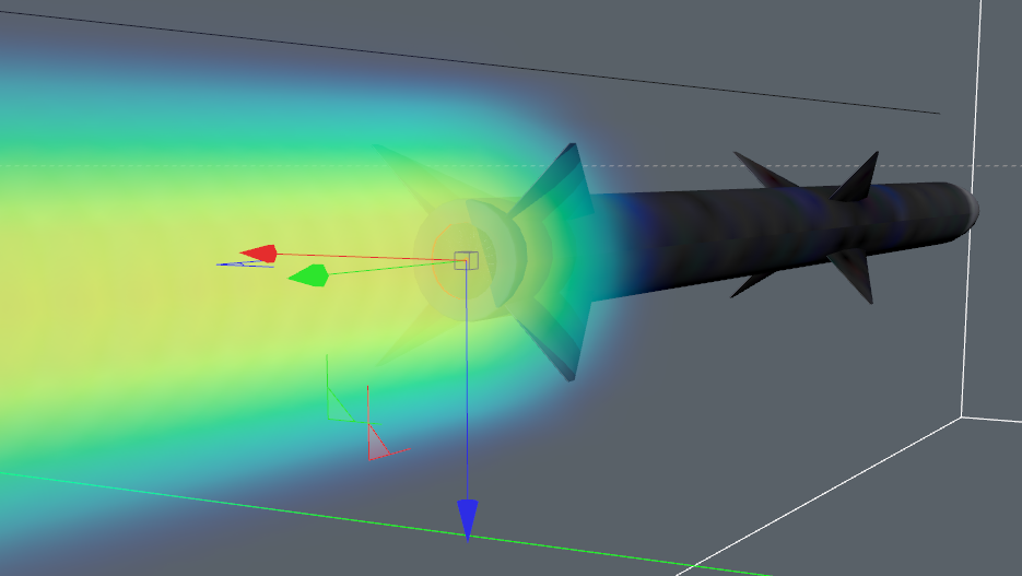

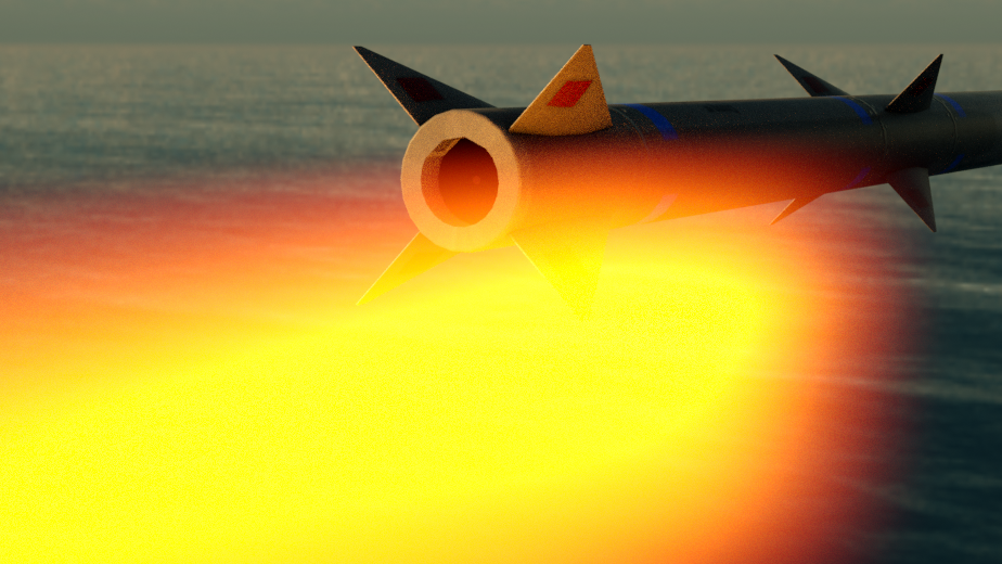

I have jet flying through a TFD container moving on xy & z with a slight banking rotation. The emitter is a disk in it's thrust area. When I run the simulation the sim particles appear where you'd expect, right where the emitter is positioned. When I render the simulation using an octane tag the position is off in XY & Z, by a few cm each. Anyone Have any ideas why this is happening? Even a small cube moving through a TFD container on the X axis has this problem. Is it a scale thing? I scaled my model down pretty significantly to allow for a smaller container.
I tried having the container as a child of the jet and positioned at the thruster but that doesn't work either.
rendered view
rendered view

Rotation of TFD volume is not supported yet. Pls try without rotation.

The volume is not rotating. I saw another forum post so I abandoned that. The volume is static, the missile is flying through it. Straight line in X.

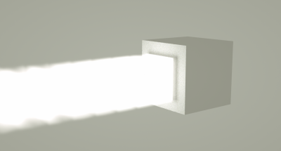

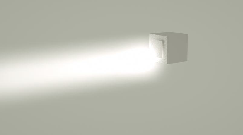

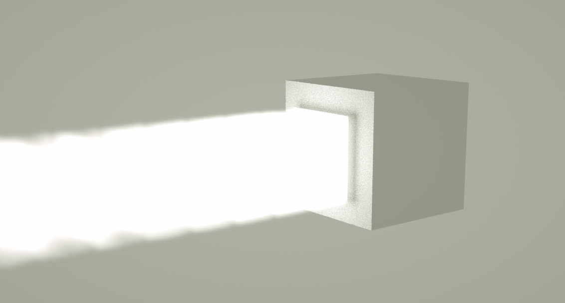

I did another test with a cube. It seems to be a scale issue. When the cube is large 25x25x25 and above the simulation renders correctly in the right spot. If I shrink the cube to 3x3x3 it's not positioned correctly.
3x3x3cm
3x3x3cm
50x50x50cm
50x50x50cm
Posts: 16068
Location: Türkiye
Can you save and send this scene?
