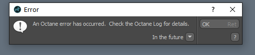

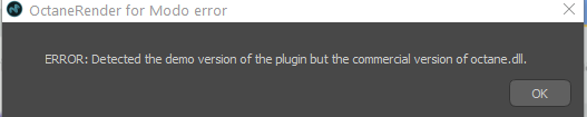

I have/own standalone license of Octane 3.x installed. I installed the OctaneRender to Modo Demo and upon startup of MODO, get:
1) ERROR: Detected the demo version of the plugin but the commercial version of octane.dll.
a) So I deactivate the standalone version, close MODO, delete my modo config file and restart MODO. I get the same error.
b) Next, I try uninstalling both the stand alone AND the plugin, restarting my computer, and then reinstalling the plugin. I get the same error.
c) Last I've tried uninstalling all octane versions on my machine as before, and any folders I find on my C drive that are Octane related. I install the plugin and get the same error.

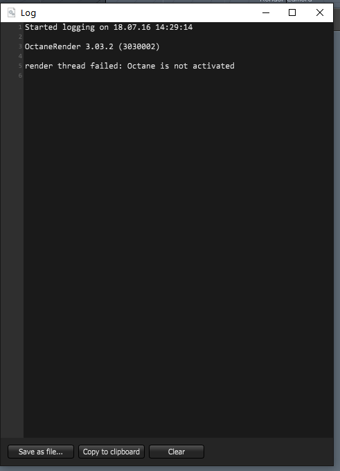

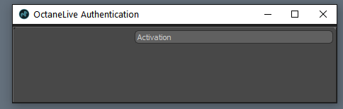

In addition to this initial error, in MODO I understandably can't activate the plugin, and get these other errors. What do I have to do to try the plugin out? What am I doing wrong? I tried looking at the plugin docs in the trouble shooting section, but didn't see anything.

My apologies - there was an error in the installer, which I have now fixed. You can download the correct installer from https://render.otoy.com/plugindownloads ... t_DEMO.exe
