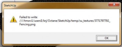

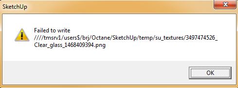

so i happens again - i modeled a scene at home - and it rendered well.
now i try to open the same scene here at work and i get the "failed to write texture" error.
i'm quite sure that it has something to do with our user profiles being on our server, and it seems that octane is using a wrong path
THIS PATH DOES NOT WORK (the one octane uses)
////tmsrv1/users$/brj/octane/sketchup/temp/su_textures
THIS PATH WORKS
there seems to be this "//" to much in the path.
please fix this, as it prevents me for working.
just to clarify - the error has not alway exists, older version of the skechup plugin did work.
i hope there is a solution.
thanks
jorgensen
failed to write texture....... two year old bug

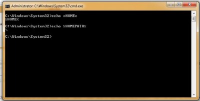

Jorgensen,
The new release I posted today includes an attempt to fix this issue. Since I haven't been able to reproduce the problem, I can't be sure my attempted fix will work; please try it out and get back to use.
Also, please check your HOME and HOMEPATH environment variables. Open a Windows CMD shell and enter and , and let me know what the results are.

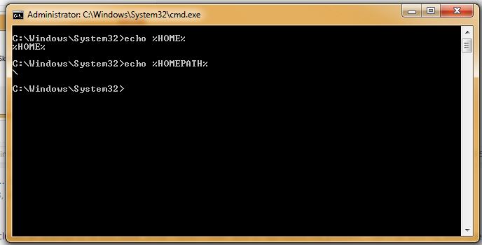

hi CaptainCrowbar
i have now tried the new 3.03.2.0 version - but i still get the same error :-/
i then used cmd and entered the text you wrote.
when i enter %HOME% - it returns %HOME% ?
when i enter %HOMEPATH% - it returns '\' - which i find a strange, as our userprofiles are on our network drive "u". (tmsrv1)
i also tried echo %userprofile% - this returns the local path c:\users\brj\
