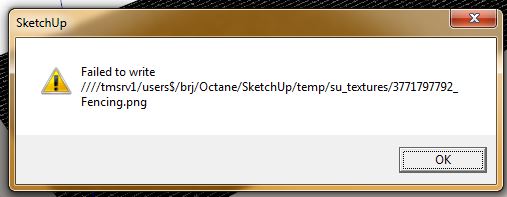

so i happens again - i modeled a scene at home - and it rendered well.
now i try to open the same scene here at work and i get the "failed to write texture" error.
i'm quite sure that it has something to do with our user profiles being on our server, and it seems that octane is using a wrong path
THIS PATH DOES NOT WORK (the one octane uses)
////tmsrv1/users$/brj/octane/sketchup/temp/su_textures
THIS PATH WORKS
there seems to be this "//" to much in the path.
please fix this, as it prevents me for working.
just to clarify - the error has not alway exists, older version of the skechup plugin did work.
i hope there is a solution.
thanks
jorgensen

Jorgensen,
The new release I posted today includes an attempt to fix this issue. Since I haven't been able to reproduce the problem, I can't be sure my attempted fix will work; please try it out and get back to use.
Also, please check your HOME and HOMEPATH environment variables. Open a Windows CMD shell and enter
Code: Select all
echo %HOME%
and
Code: Select all
echo %HOMEPATH%
, and let me know what the results are.

i have now tried the new 3.03.2.0 version - but i still get the same error :-/
i then used cmd and entered the text you wrote.
when i enter %HOME% - it returns %HOME% ?
when i enter %HOMEPATH% - it returns '\' - which i find a strange, as our userprofiles are on our network drive "u". (tmsrv1)
i also tried echo %userprofile% - this returns the local path c:\users\brj\
jorgensen

It is possible that this issue originates in the Standalone, rather than the plugin. I will need to talk with core developers to confirm. There have been known issues of this nature in the past with the standalone.
Thank you for reporting this issue, we will get to the bottom of this as soon as we can.

I've just posted a new build (3.03.2.2) with some further changes to the file path handling code. Please give this a try and let me know if it fixes your problem.

sadly the same error.
but i just tried to copy the octane plugin
from
C:\Users\brj\AppData\Roaming\SketchUp\SketchUp 2016\SketchUp\Plugins
to
C:\Users\brj\AppData\Roaming\SketchUp\SketchUp 2015\SketchUp\Plugins
and now i don't get the error when using skectup 2015??

I just insured that 2016 was running as administrator - it wasn't, changed to it runs as administrator - but that made no difference :-/
