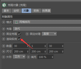

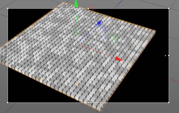

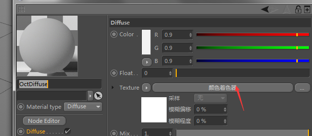

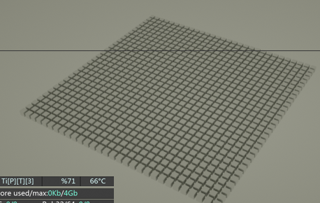

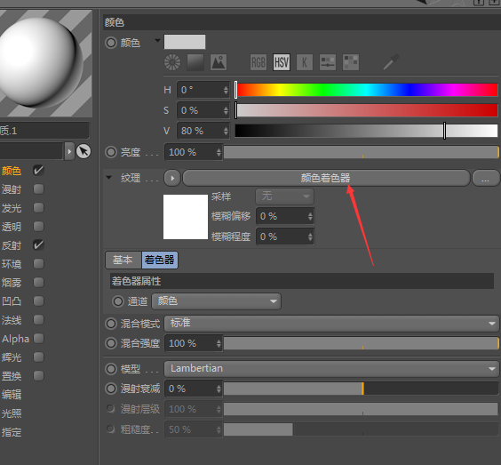

when i use Shader Effector with cloner 's render instances ,the default render is well .but octane is not work with shader effector +cloner's rander instance

Hi, we're not standard renderer. It works in own logic. It should be mentioned a few times before.
- Mograph colors work just with instances.
- Random color works with render instances.
These are possibilities with current capacity of renderer.

thank you for your answer .how can i use Shader Effector with cloner's render instances ,because render instances will use less VGA memory

I've answered. You can't...

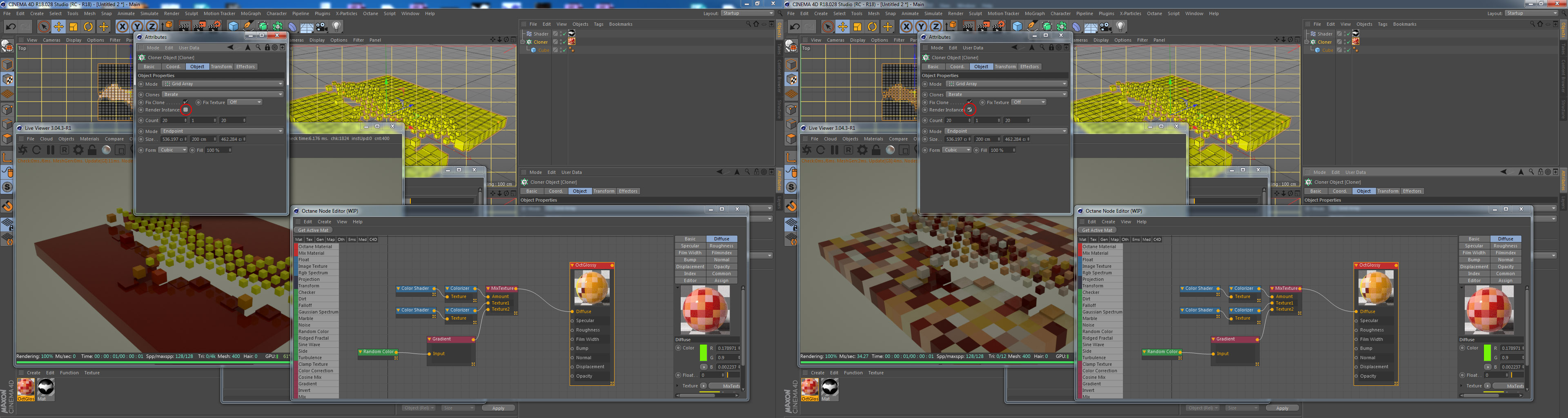

Hi Aoktar,
Is there a way to use mograph color in conjunction with shader effector ??
I want to have random color and also want to effect certain clones with shader effector and make them yellow. Right now I'm getting only one at a time.
Cheers !!

@Sagun:
You're asking same topic. Answered already.
viewtopic.php?f=30&t=57395#p294787

Thank you ! I already knew that limitation. I got alternative method to get that result :)

Limitations will be removed when Octane support the custom colors over instances
