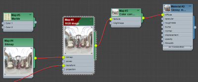

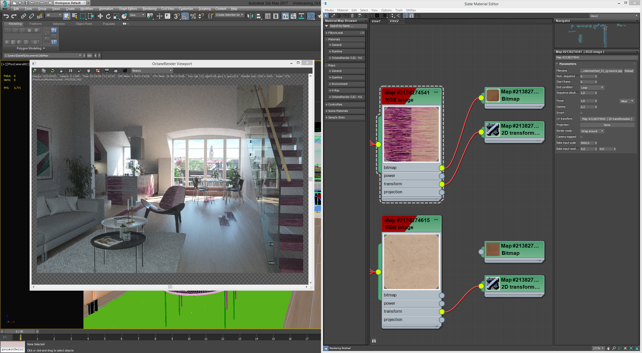

Regular 3ds max bitmaps plugged in to the rgb image node is completely broken.
I have attached a image showing this (all the purple error everywhere).
If I copy the texture location and paste it in to the rgb image everything works as it should.
