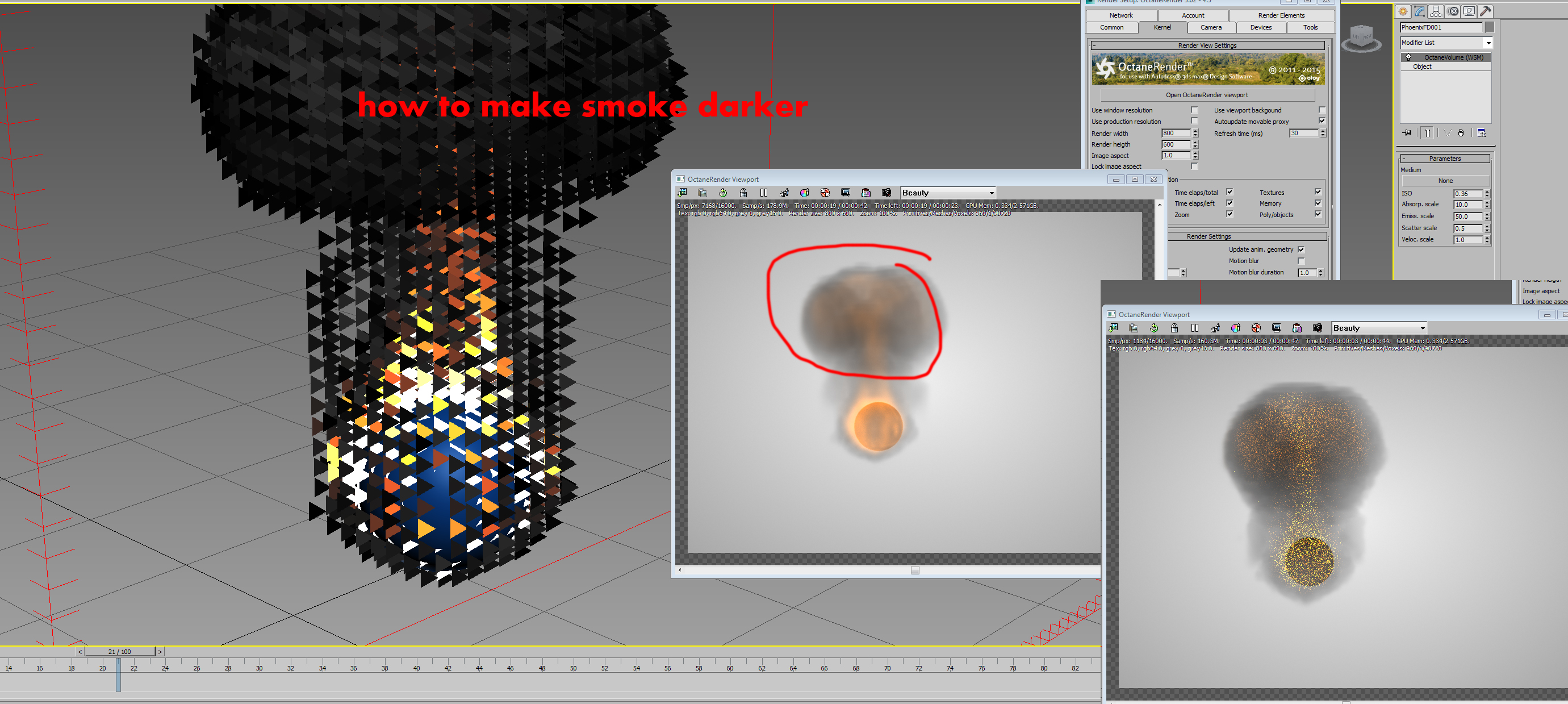

Hi we use phoenix fd and smoke seems too clear. Changing absorb scale makes fire look very noisy.
Scatter scale makes fire less visible.
Any way to use textures or just change smoke color or flame color manually somehow? etc

Hi coilbook, it looks like you should try to decrease your volume step length

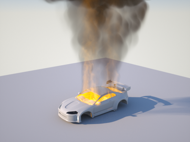

seems like fire still looks to clear
Jimstar got it to work with phoenix and all we have is absorp scale emission scale scatter scale

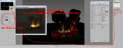

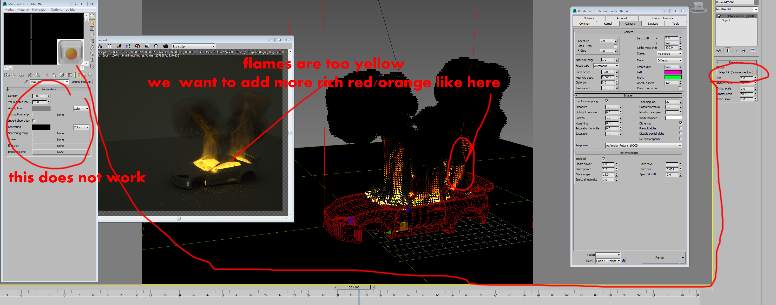

We are trying to achieve rich orange red flames but get pale yellow. IS there anyway to change color of flames like in the picture.

there is a medium button in Phoenix OctaneVolume
So we assign Volume Medium and try to change flame color but cannot? How can change flame/smoke color? Thanks

Remember that for the color of the flames to shine through the smoke, the smoke must scatter light. Make sure your scattering color is not black, make it white while you are adjusting the color of the flames. The volume step length should work if you set it to something much smaller, such as 1 or 2
