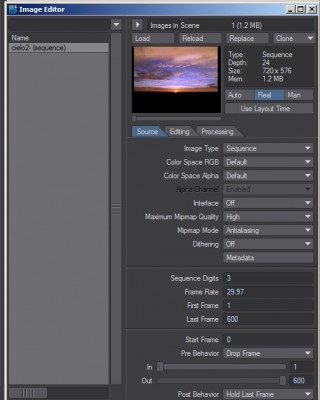

Is it possible to map animation using image Sequence Map?
It seems that does not apply to the animation trying to Sequence Image.
juanjgon
Posts: 8867
Location: Spain
If you load an image as a sequence in the LightWave image editor, it should work in Octane without problems, but due to some limitations in the LightWave SDK, some controls, like the start frame, pre behavior, etc. can not work.

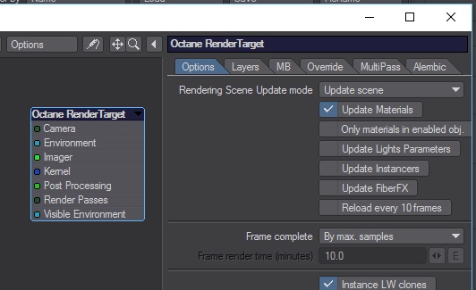

juanjgon
Posts: 8867
Location: Spain
How are you rendering the animation, in "update" or in "full scene reload" mode? If you are rendering the scene in "update" mode, you must enable the "update materials" option to support the image sequences.
Thanks,
-Juanjo
spigolo
Posts: 292
Joined: Fri Jun 04, 2010 5:16 am
Location: Florence Italy
i thought that but it doesen't seems to work...
Will do some other test and in case submite a sample scene ok?
3dsign studio
Advanced visual communication
http://www.3dsign.it
juanjgon
Posts: 8867
Location: Spain
Sure, no problem. If you have a scene with this problem I could test it here.
You are loading the image sequence inside the LW image editor, right?
-Juanjo

Im doing a test now I think there was a problem in the first image generate by realflow numbered 00000
the image was flat and image editor shows it fully black
Deleted that one it seems to work im rendering it now 15 frames as a test.
The nice thing is that realwave displacement are tileble so im displacing a scquare and instancing an array of them and you don't see in octane any
connection.
Will let you know if it works
thanks

it works...
does the loop option work of image sequences or not?
