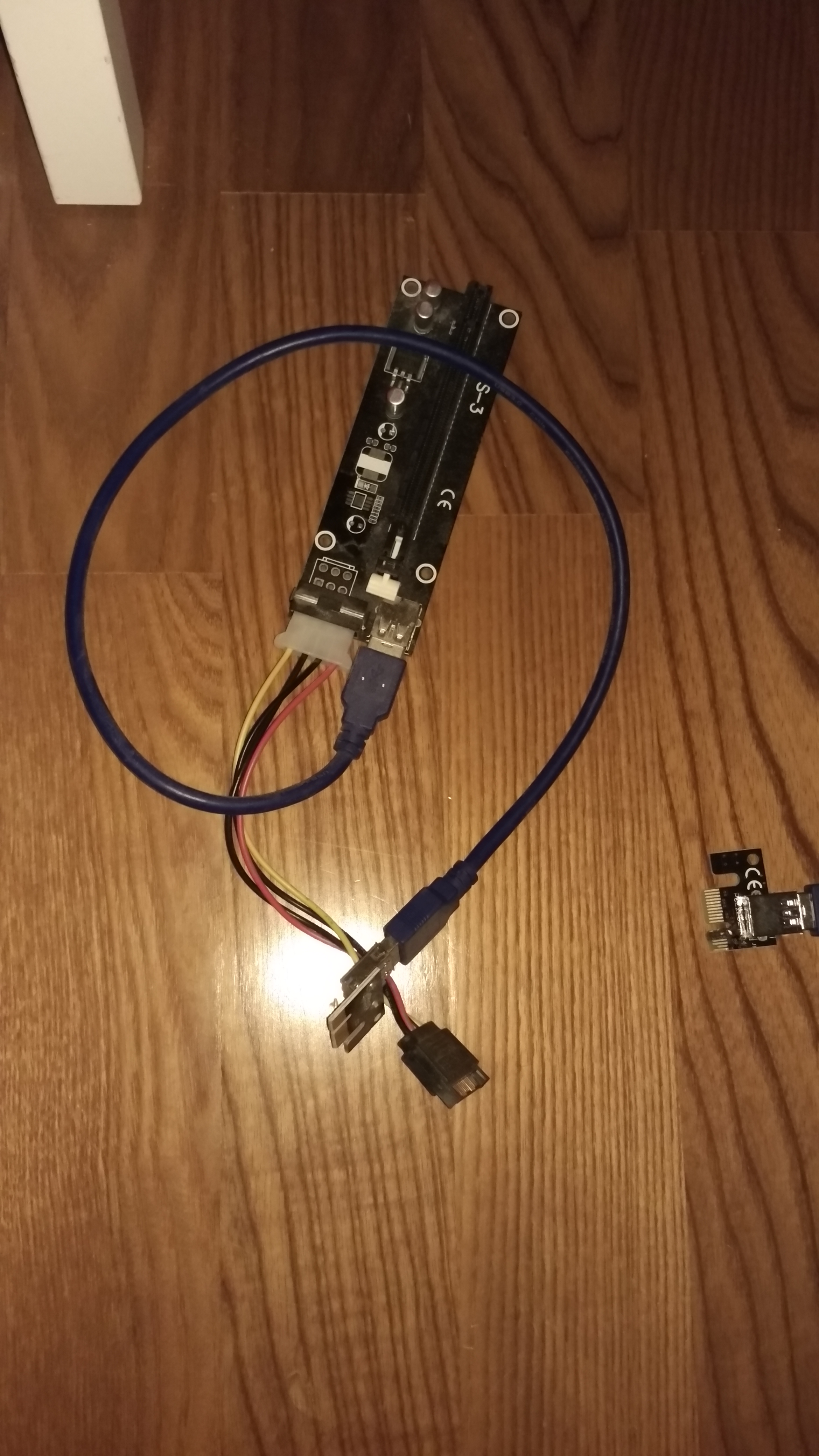

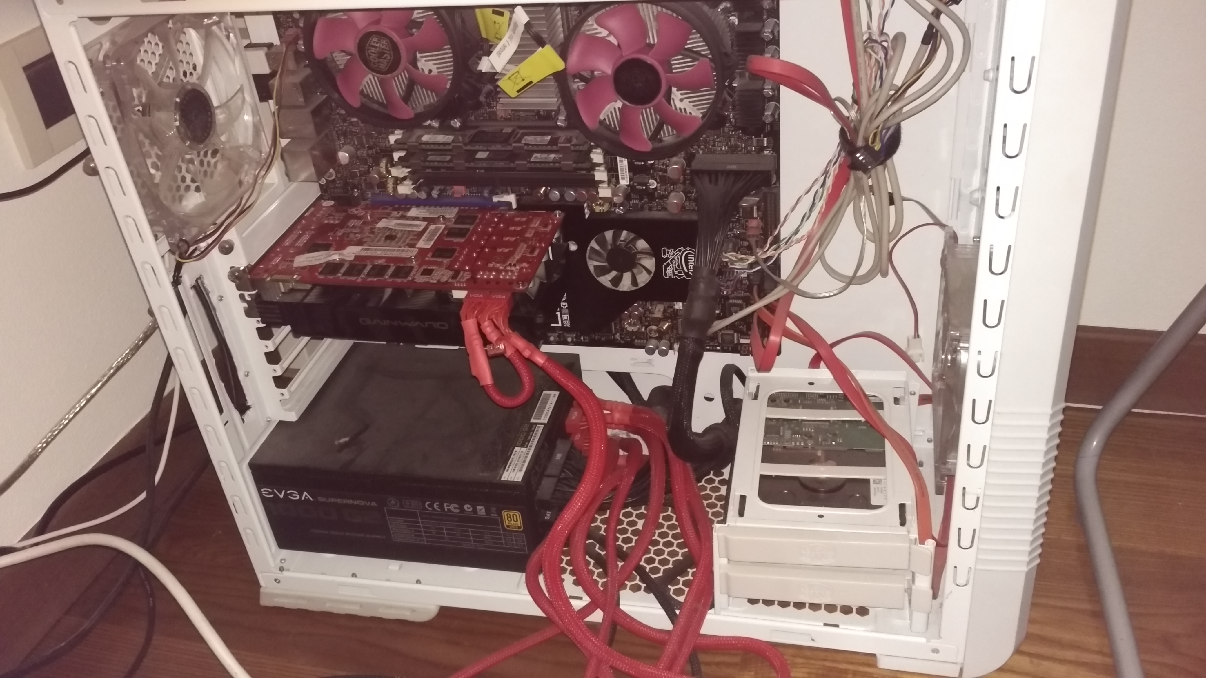

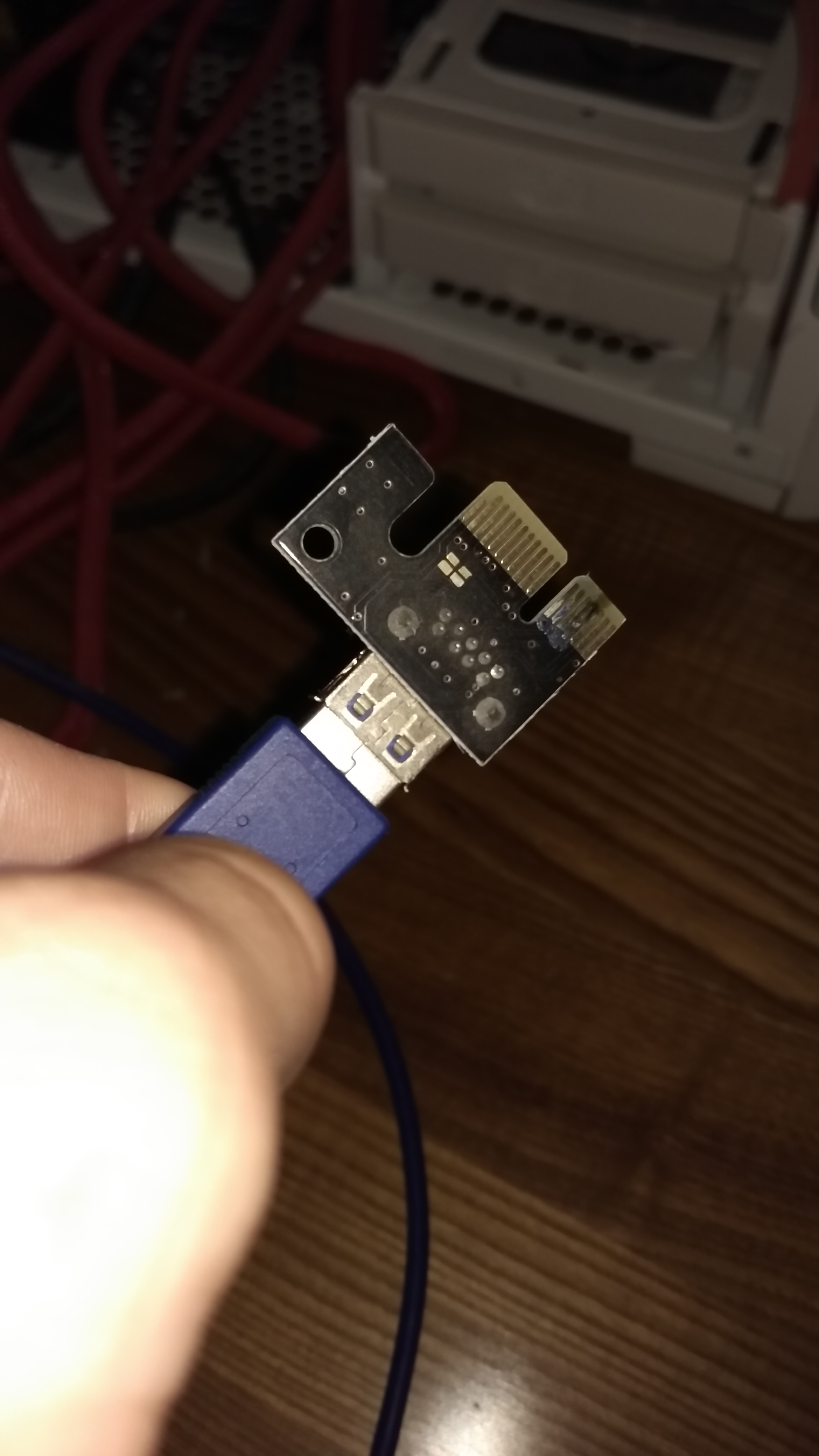

Unfortunately, bad news.
I have removed all the cards to clean from dust,
I put everything I have on, and the two extensions linking video cards with the motherboard, are burned !! came out of the big smoke and now windows will not start.
It turns on your PC but does not load win ... maybe the motherboard has to be thrown away I think !!: D
