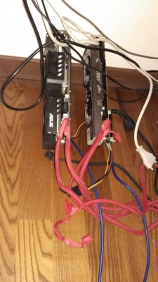

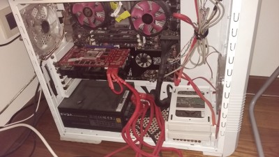

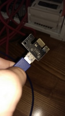

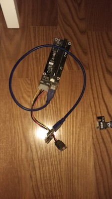

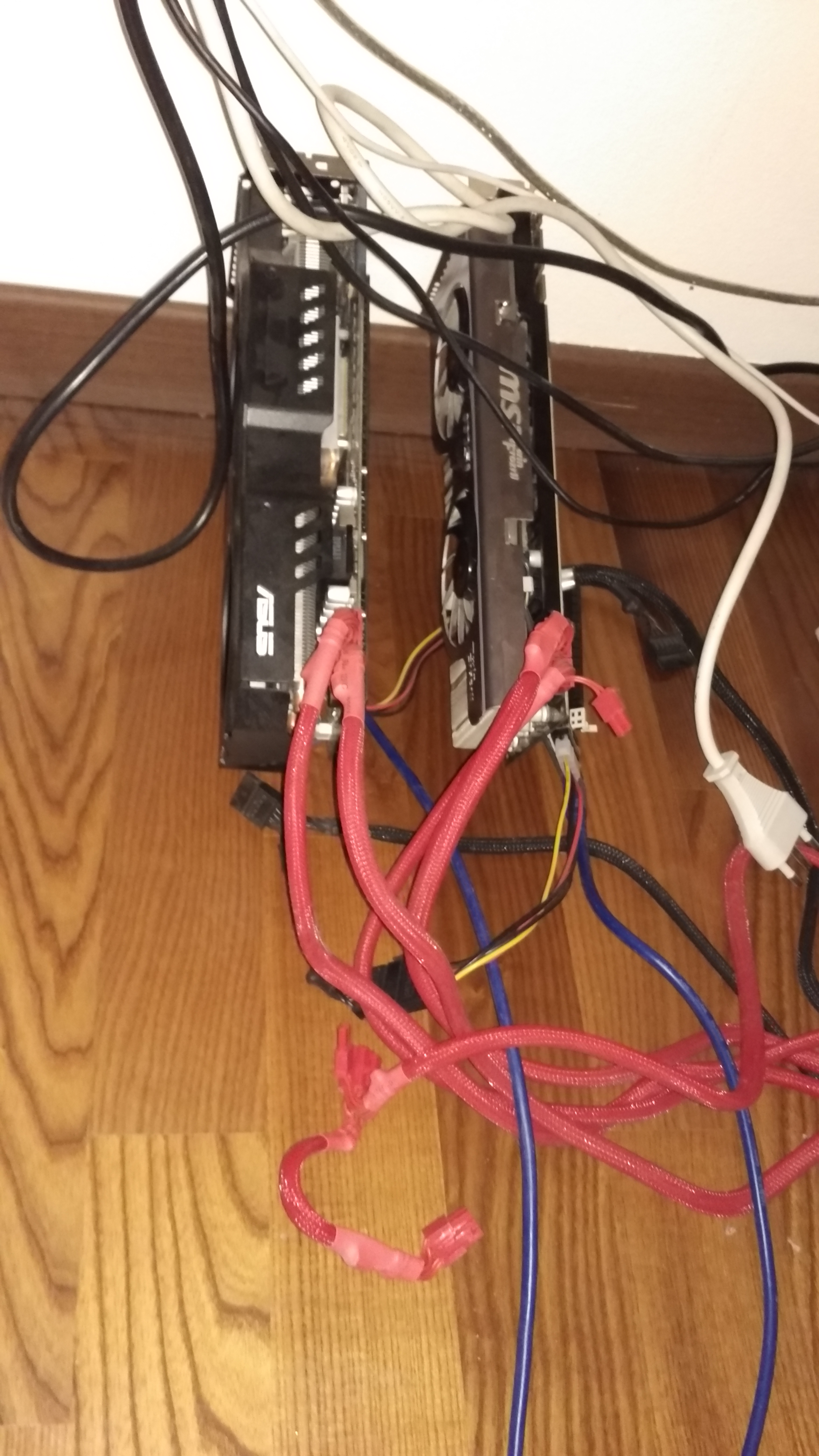

Unfortunately, bad news.
I have removed all the cards to clean from dust,
I put everything I have on, and the two extensions linking video cards with the motherboard, are burned !! came out of the big smoke and now windows will not start.
It turns on your PC but does not load win ... maybe the motherboard has to be thrown away I think !!: D
SORRY, MY ENGLISH IS BAD!
2 Xeon quad core E5440_8gb Ram_Nvidia GeForce 2GTX 780ti 3Gb/Nvidia Quadro K2000_Win10 64bit_Octane 3.02_Rhinoceros3D
