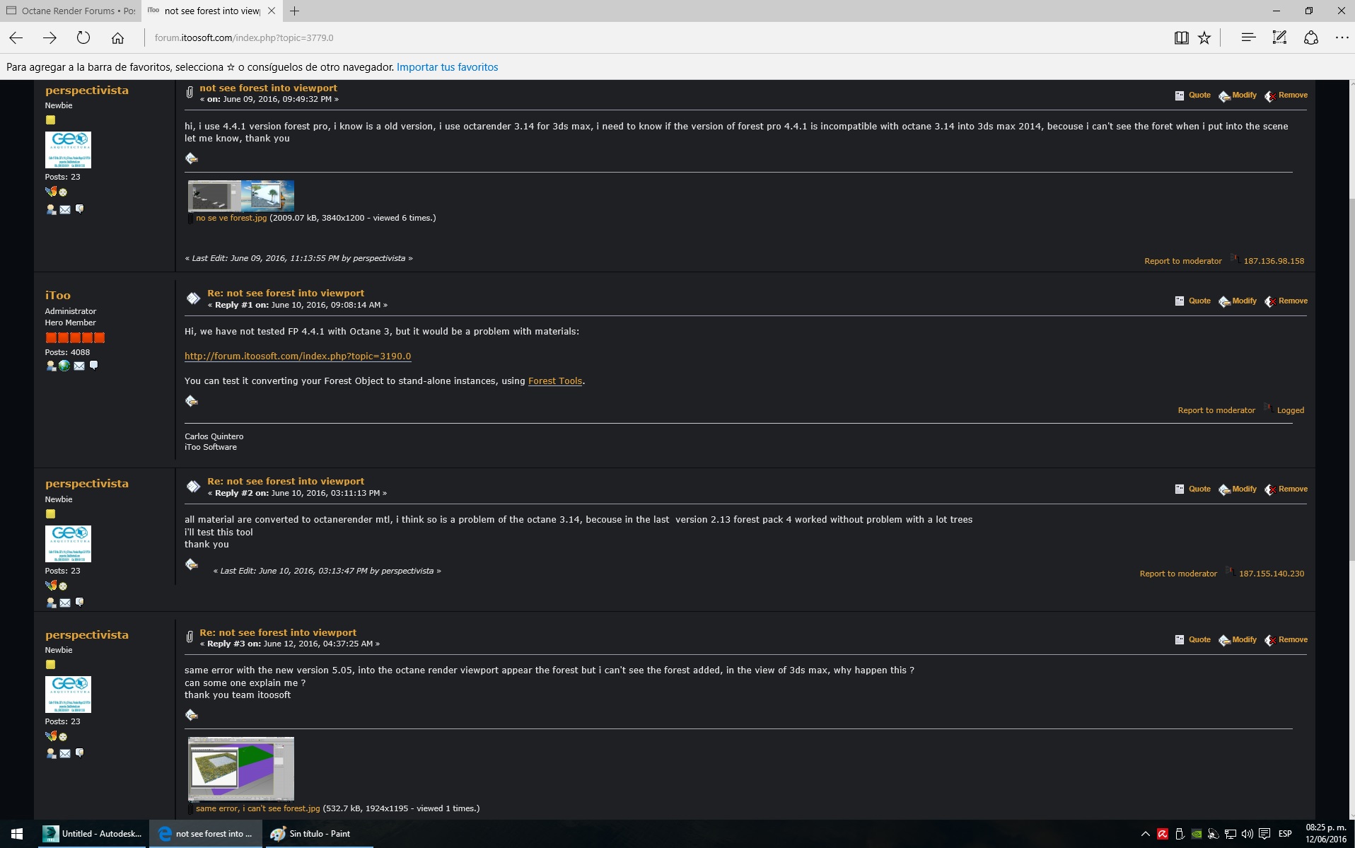

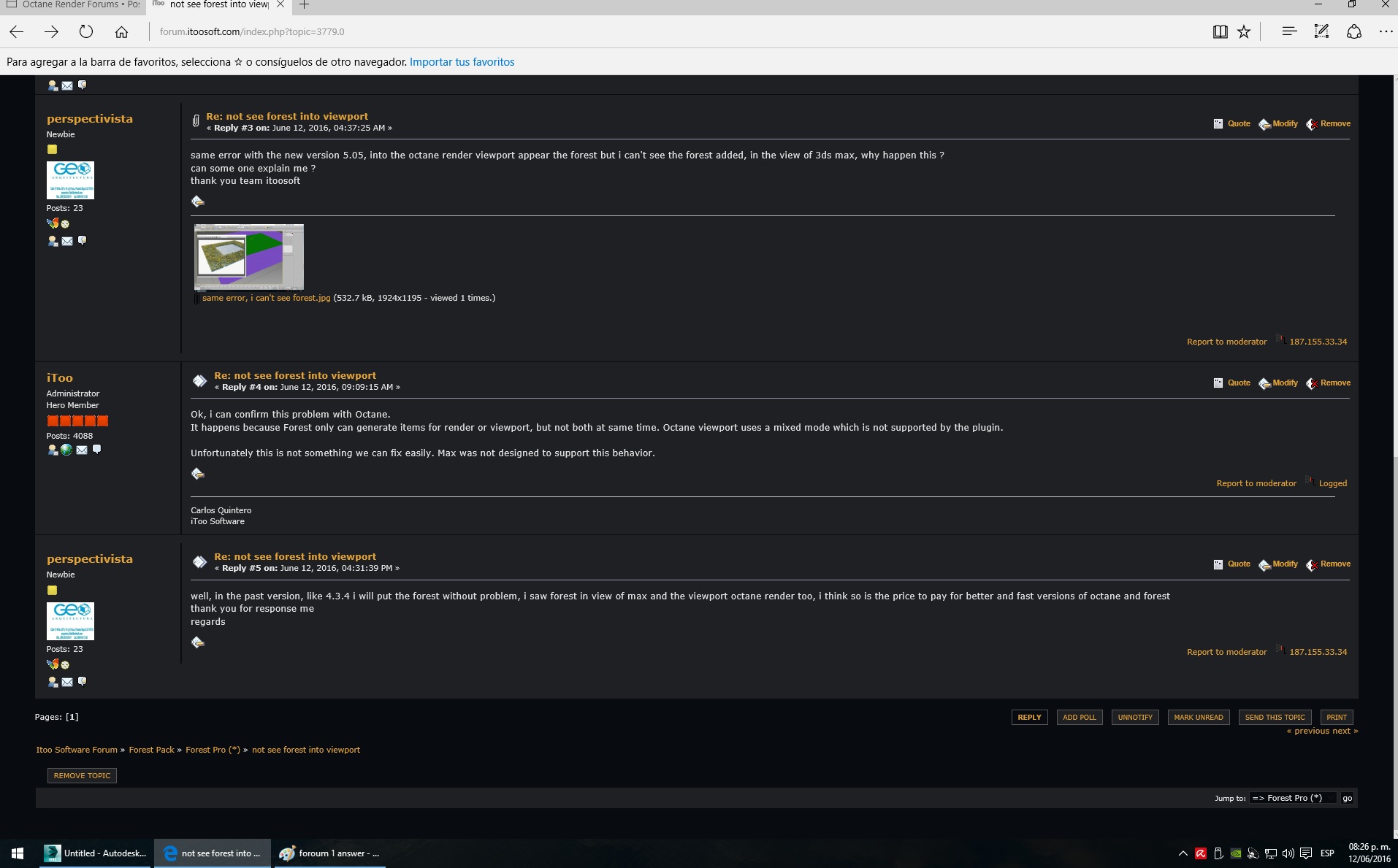

hello team octane render team, i have a problem with to see the objects forest into octane render i have in use 5.0.5 forest pack versi{on i been talked with the administrador of the itoosoft and this was your words:
add image to see answer:
hope you can understand this problem into octane with forest or forest with octane
thank you team octane render

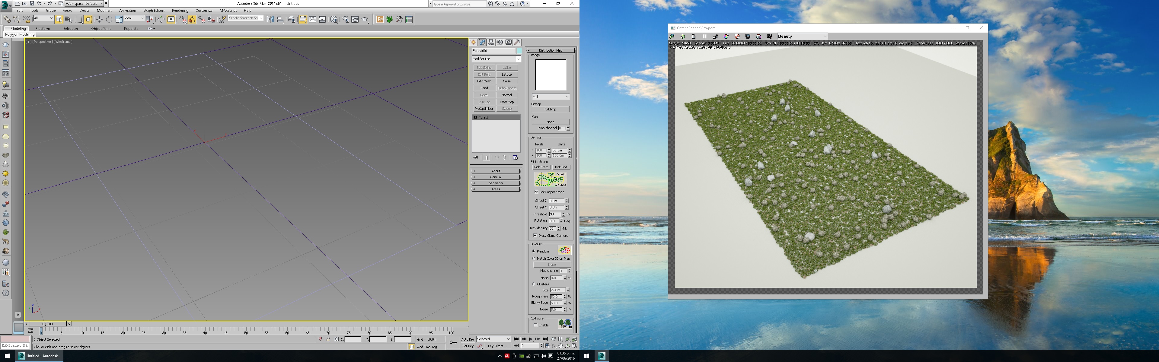

viewport octane
viewport octane
viewport 3ds max
viewport 3ds max

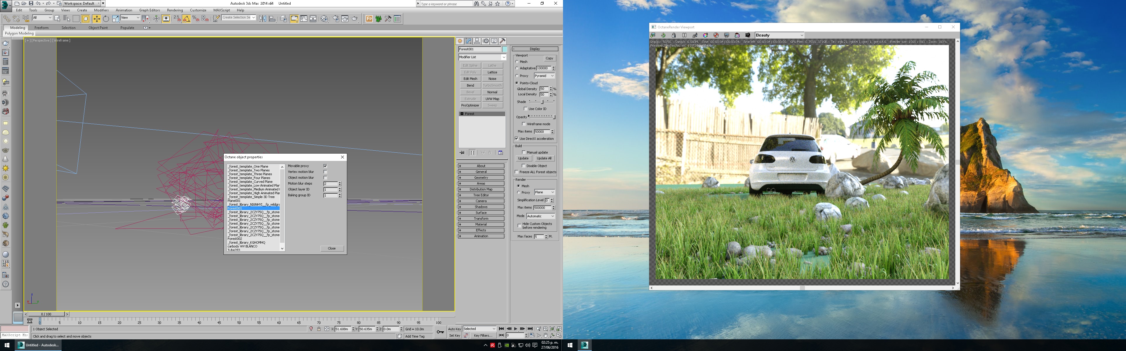

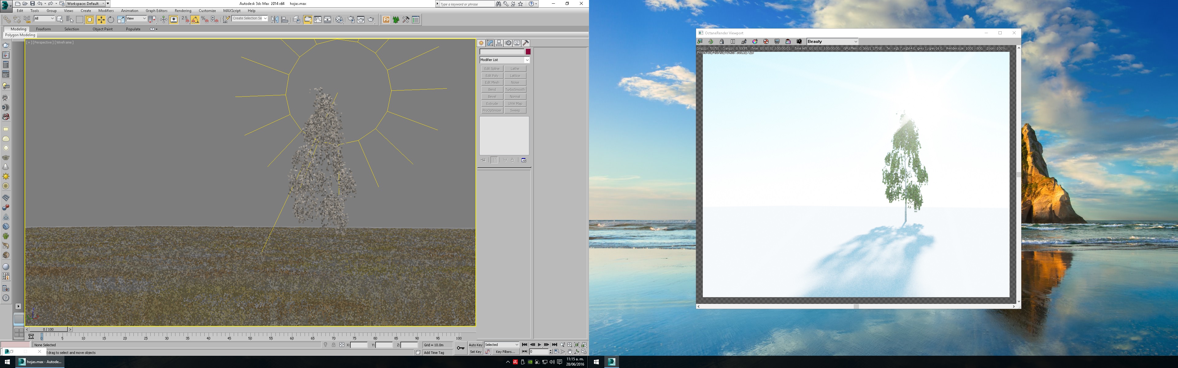

answer 1
answer 1
asnwer 2
asnwer 2

add image
is the same i can't see forest when viewport octane is open

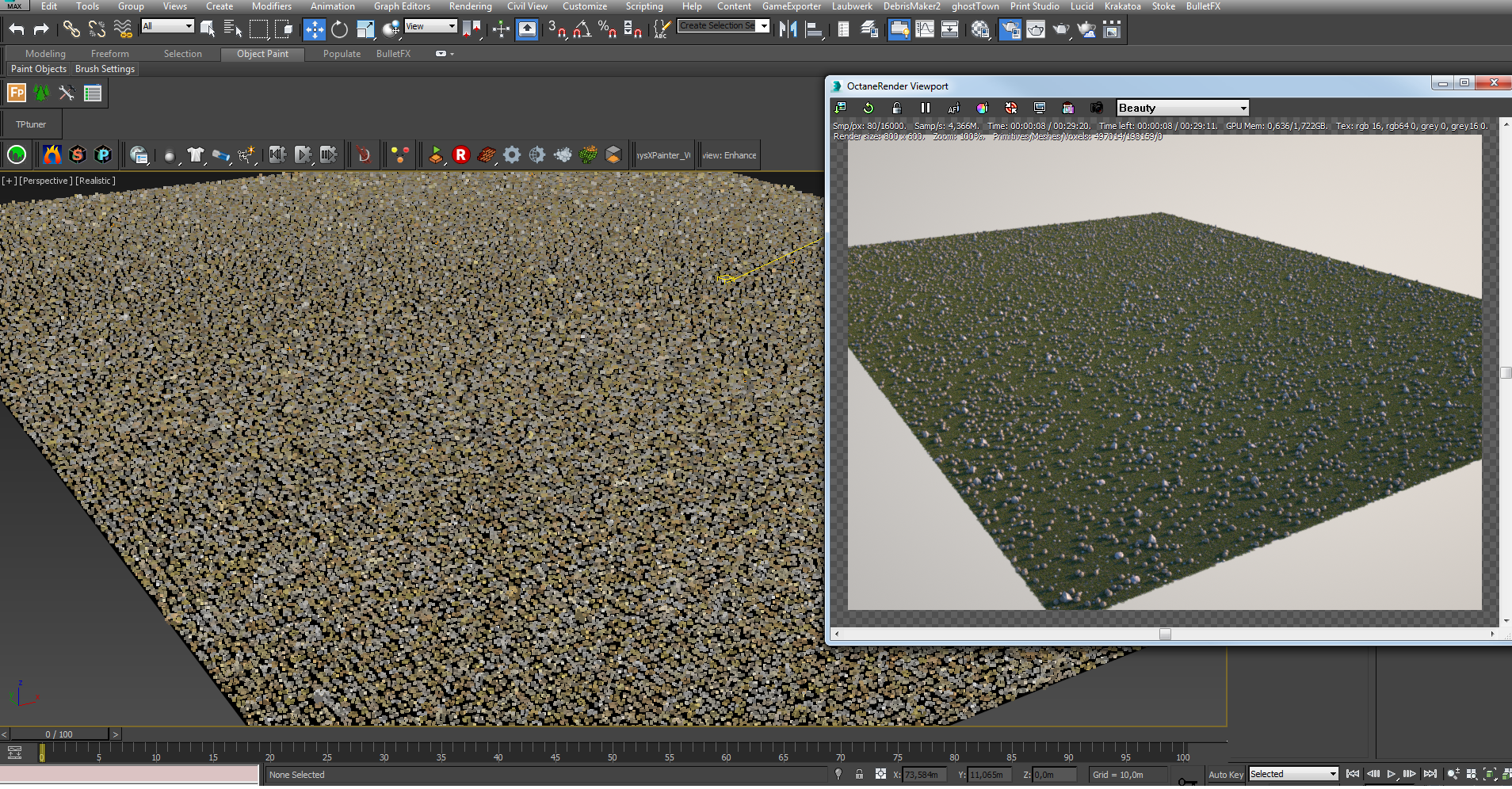

Fine here.
Max 2016
Octane V4 Test
Win 7 64 | Geforce GTX780 |Dual X5667 Xeon | 40GB | MAX 2016 |

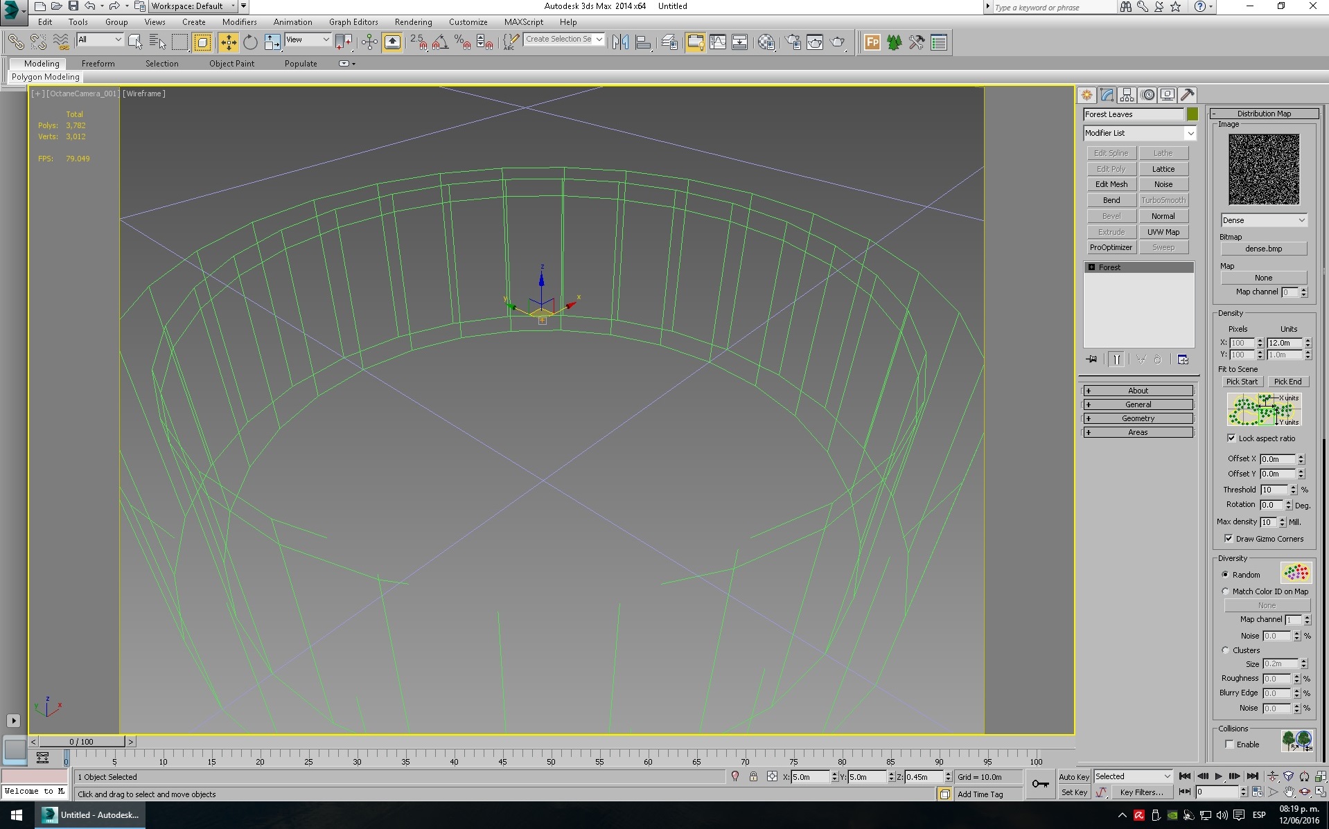

add image, always is the same error with my octane and forest
i think so the movable poxy is the problem, do no apply to forest the option movable proxy

no very basic setup.. just a plane with forrest pack.. no settings changed.

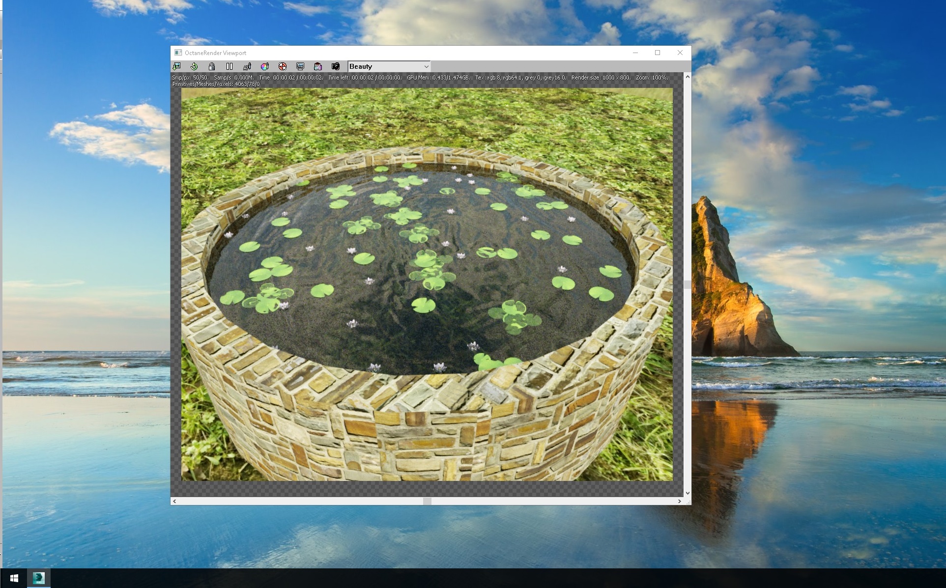

still i can't see forest into viewport octane when i active movable proxy, is a problema becouse still time when i insert a forest and chanche the properties i need do click in refresh to appear the forest and that is a headache
exist another way to do more interactive forest with octane or is the only way ?
thank you for answer octanerender team
