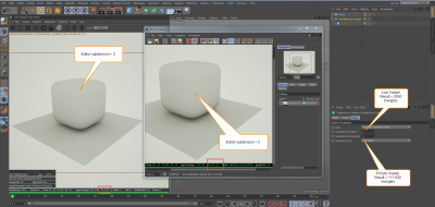

I'll divide and check your scene. About subdivisions, LV use viewport polygons but final render use render data. In other word editor parameter is for LV, render parameter is for PV. So in picture viewer you'll get much more polygons against LV in this case.
