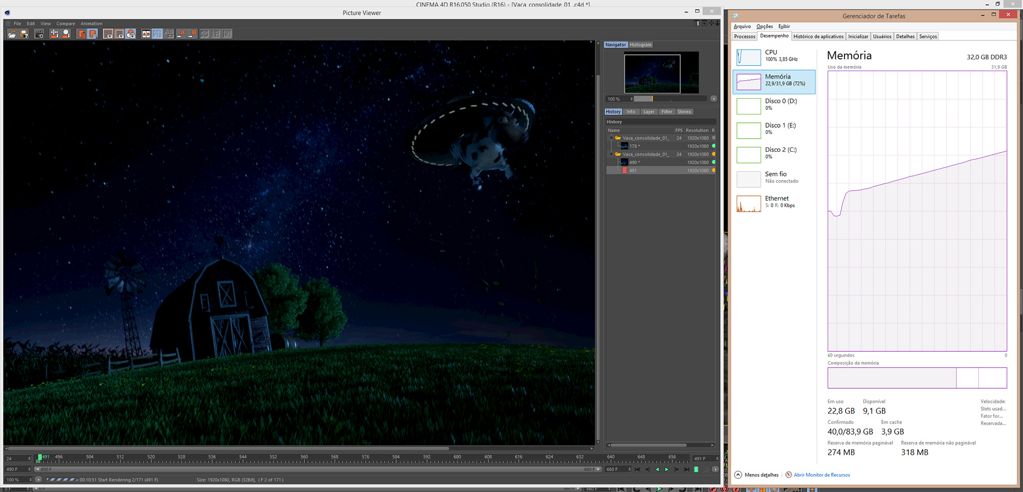

the animation's full lenght is 660 frames, when i reach frame number 480 or so, octane behaves really weird, first, i noticed a huge memory hog happened and this leads to a crash.
Then i tried to render again from where it stoped(480), results are:
everytime i try to render it, it renders one frame, and then when it tries to render the second frame the memory hog kicks in untill the program crashes.

EDIT 4: Memory hog comes back after frame 512!!!! mother fucker.... so, Hair isn't the one to blame, what is it then?
What buggs me is why would it give me trouble around frame 480 and not form the very start? it looks like it just starts caching endlessly untill it crashes.

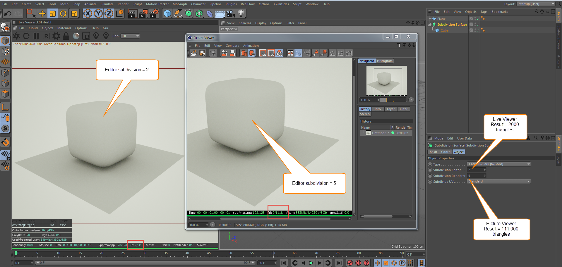

I'll divide and check your scene. About subdivisions, LV use viewport polygons but final render use render data. In other word editor parameter is for LV, render parameter is for PV. So in picture viewer you'll get much more polygons against LV in this case.
