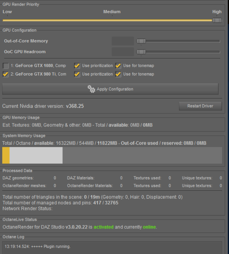

I have just installed a 1080 GTX graphics card on my computer but Daz Octane render does not seem to use it when rendering. In the control panel, everything looks ok out, and Octane window, I see both cards but every time I start Daz so GTX 1080 disabled. When I activate the card with the check box and Apply config not updated amount of memory (8GB).
Even at a rendering so it says 1 GPU in the window?
Anyone know how I can fix this problem?
Windows 10 64 bit
Daz Studio 4.9 Pro
OctaneRender_for_DazStudio_3_0_20_22_Win64
Nivida 368.25 driver

I found the information that the 1080 is not supported by Octane jet:
natemac00 wrote:Pascal GPU architecture is not a supported in Octane yet, once the card is actually released, they can test the GPU and get it supported, it's just how soon that might happen this is the question.
I don't know what the Mac OS issues he's talking about though, I've never had any issues and I'm not moving away from Mac anytime soon.
Found here: viewtopic.php?f=9&t=43439&hilit=1080&start=170#p276419

And here I found the information that the support comes in August:
gabrielefx wrote:Pascal works only with Cuda 8.0. It will be released in August.
At the moment you can play games with the 1080.
Found here: viewtopic.php?f=30&t=54438#p277192

Oops, should have looked into this more carefully before I bought new card.
Really hope Octane supports GTX 1080 as soon as possible, probably many who have questions about purchasing this card.
Thanks for the information.
