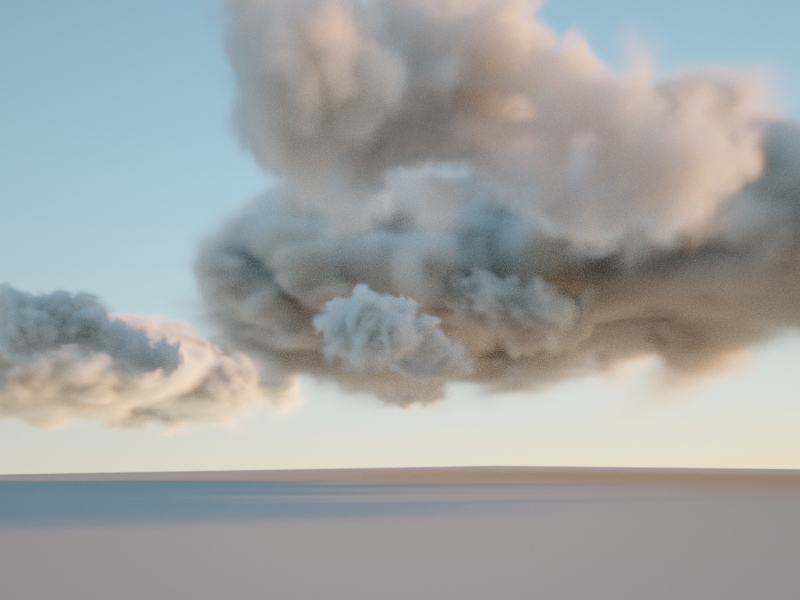

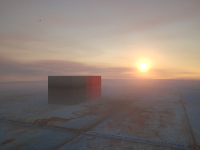

did some tests.
you can create your own vdb files using fumefx or houdini if you have access to it.
or download sample vdbs from http://www.openvdb.org/download/
create a octane volume and link the vdb, place a "volume medium" an play with the values in material editor.. the "volume step length" is one important value.
PS: renderings took a minute or two. so speed is quite good i think.
