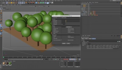

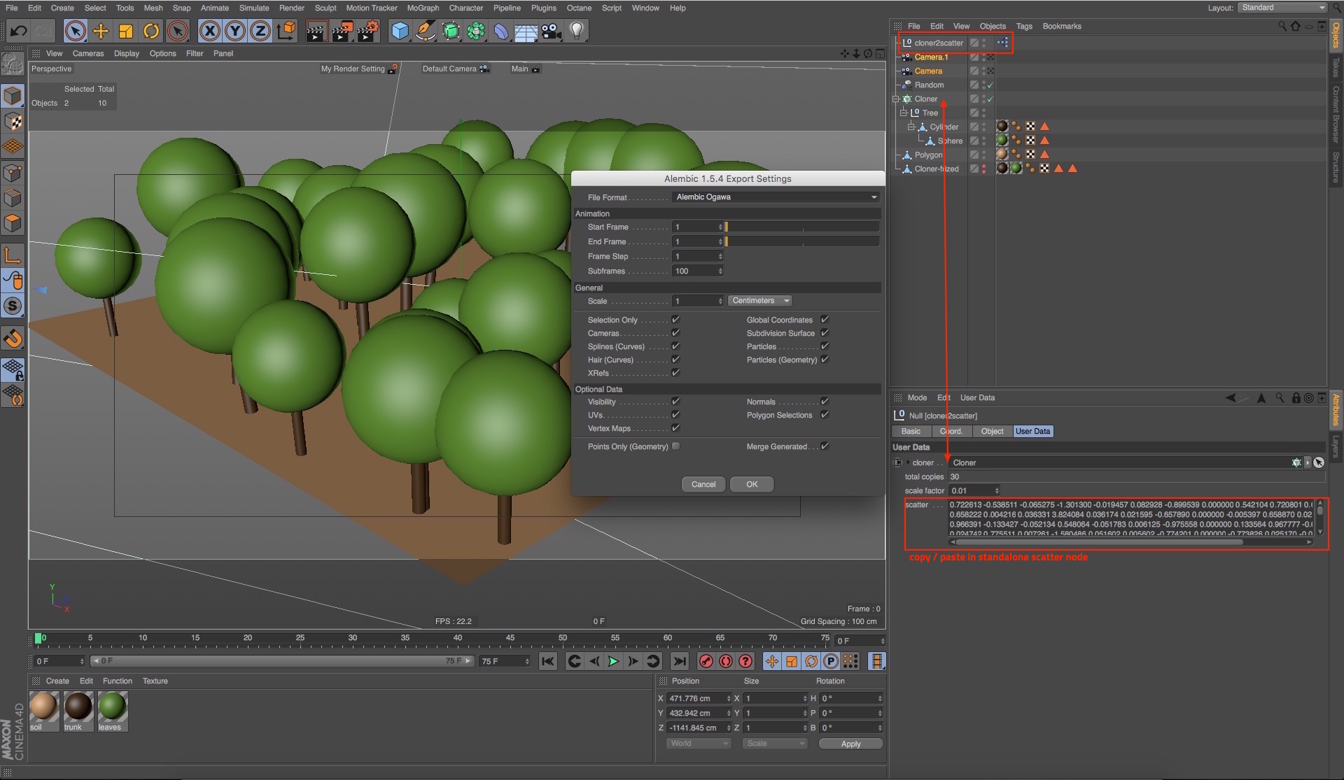

here is an example scene in c4d with mograph cloner, export from c4d in different -abc files (cameras, tree, plane) by ticking the "Selection Only" option:

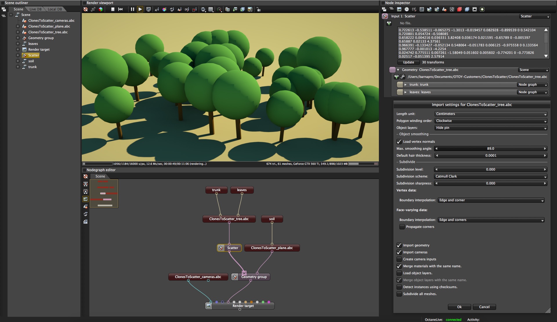

imported in standalone by changing the scale from meters to centimeters and copy pasted the matrix from c4d clone2scatter into octane scatter object:

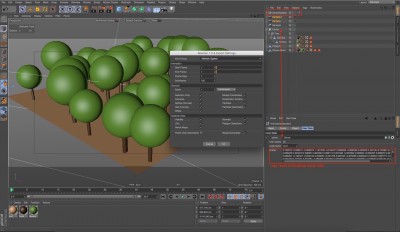

in the c4d file there is the clone2scatter xpresso, just drag and drop your mograph clone in the "cloner" slot and copy the resulting series of matrix and paste it in a standalone scatter node:
