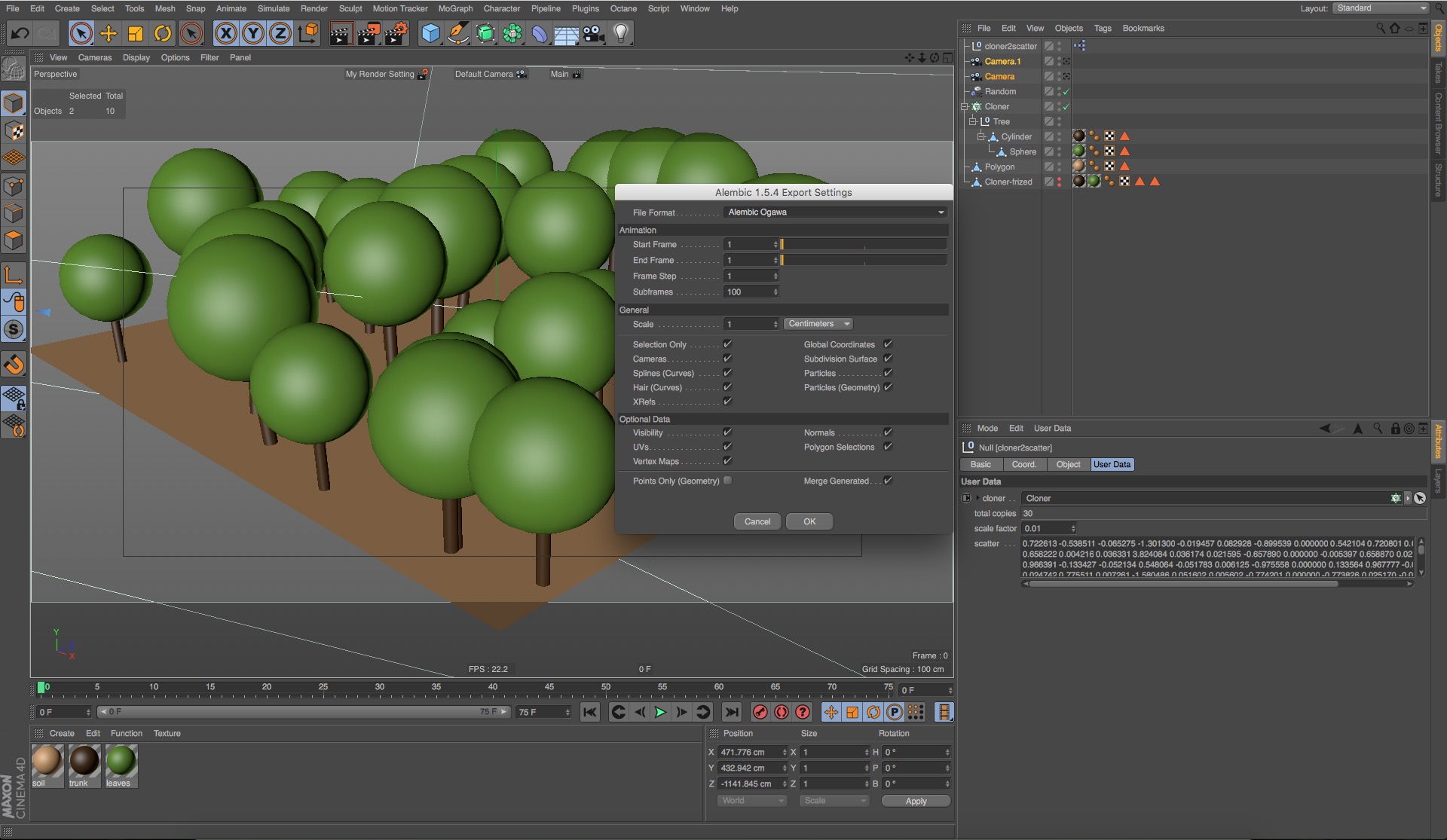

How would I make the instances scattered on an object such as a plane in Octane?
Hi guyhoka,
here is an example scene in c4d with mograph cloner, export from c4d in different -abc files (cameras, tree, plane) by ticking the "Selection Only" option: imported in standalone by changing the scale from meters to centimeters and copy pasted the matrix from c4d clone2scatter into octane scatter object: ciao beppe
Hi guyhoka,
in the c4d file there is the clone2scatter xpresso, just drag and drop your mograph clone in the "cloner" slot and copy the resulting series of matrix and paste it in a standalone scatter node: ciao beppe
