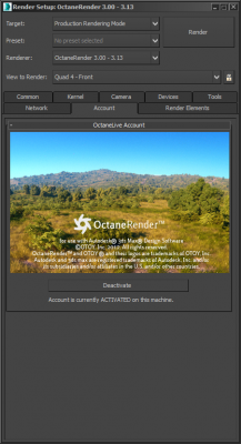

Licenses are released (deactivated) automatically when you close a plugin. If that's not happening you may have chosen to use "Offline licensing" at the time you signed out.
When in offline mode all plugins should provide a button to deactivate the license in use by that specific plugin. As a way of example this is how it looks like in 3Ds Max:
3Ds Max Deactivation
Please refer to the 3.0 new features post if you need more information.
