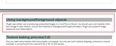

I've tried this but the alpha background keeps showing up. Octane just completely ignores the C4D background object.Ibycus wrote:You can add a C4D background object, then put a C4D material on that background, add color to the texture spot under diffuse, and select alpha channel in the Kernel in octane settings.

A C4D background object simply does nothing in Octane live preview. Nothing shows up at all with or without the Alpha channel checked.
EDIT: Oh my god, I just figured it out. I needed to use the Octane RGBSpectrum for the texture in the color channel. Before, I was just using the C4D color channel and nothing was happening, whoops. Thanks for the support though!
