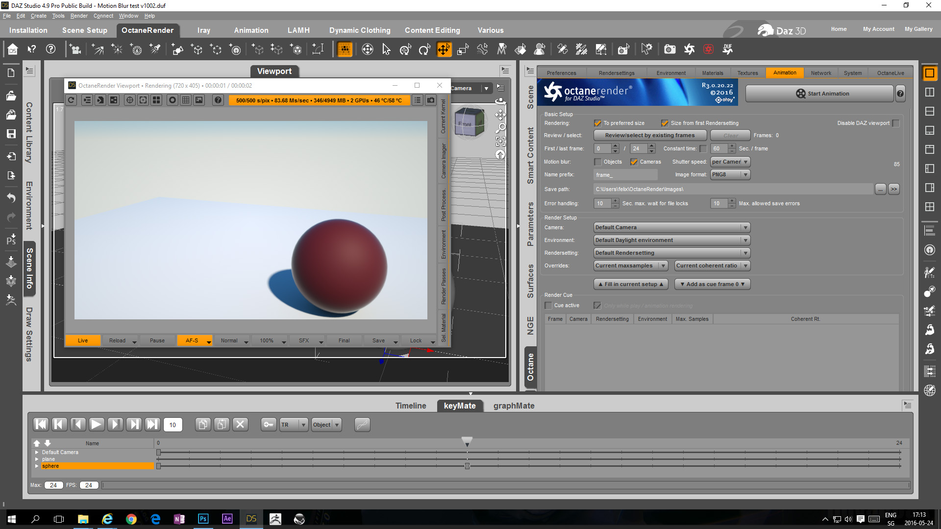

With Build 3.0.20.22 dimension values set in the Render Settings are not used when rendering an animation.
-> The resolution and framing of the image in the animation rendering is different than in a single image rendering with the same camera.
No clue why but here is what happend:

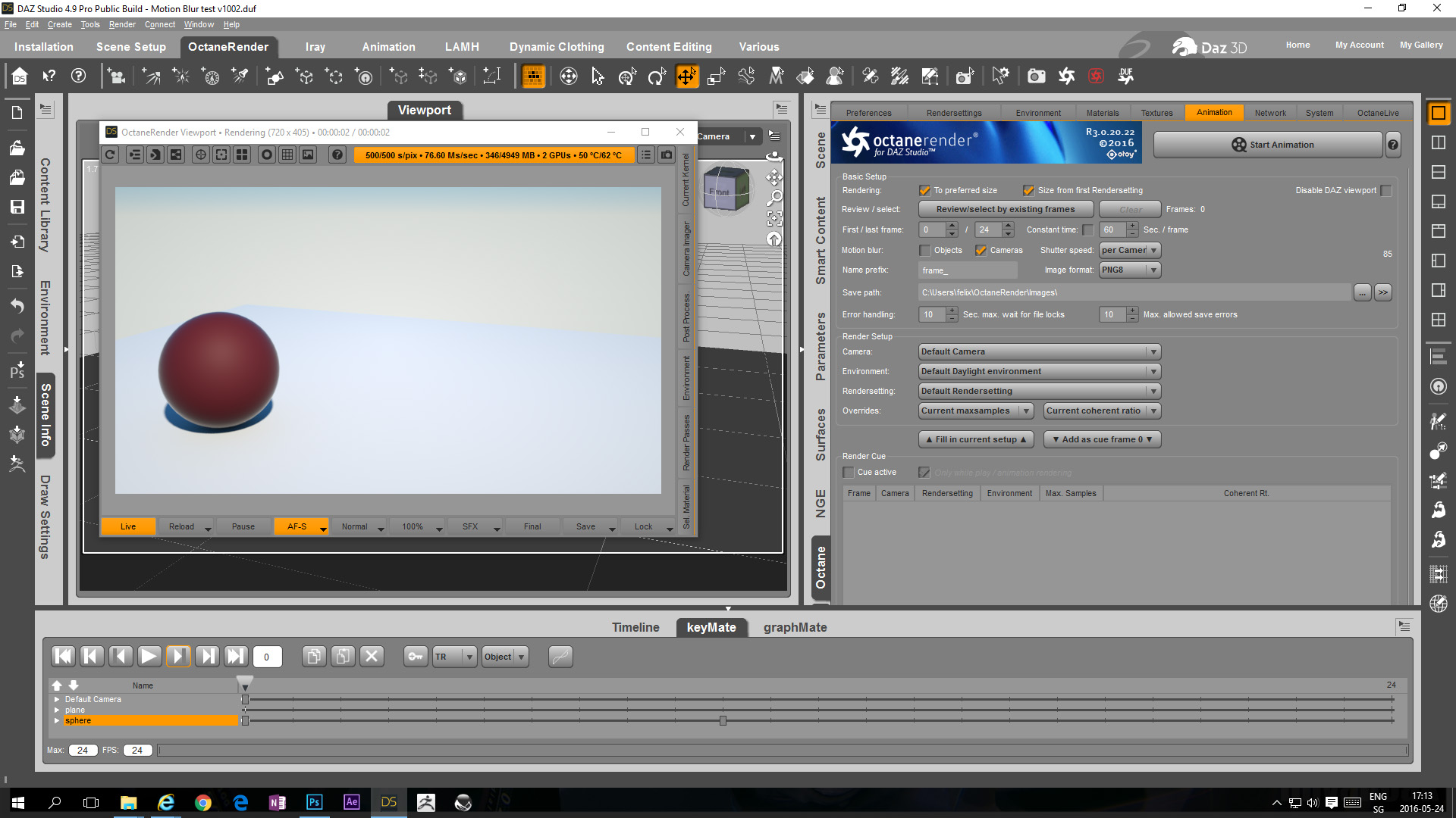

Test Scene:
Render Setting selected Dimension: 720x405 (16:9)
Sphere Position Frame 1
Sphere Position Frame 10

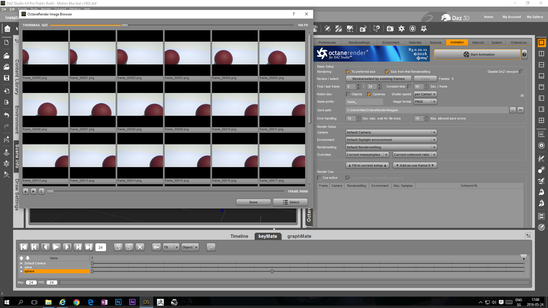

What the animation preview looks like in ORIB

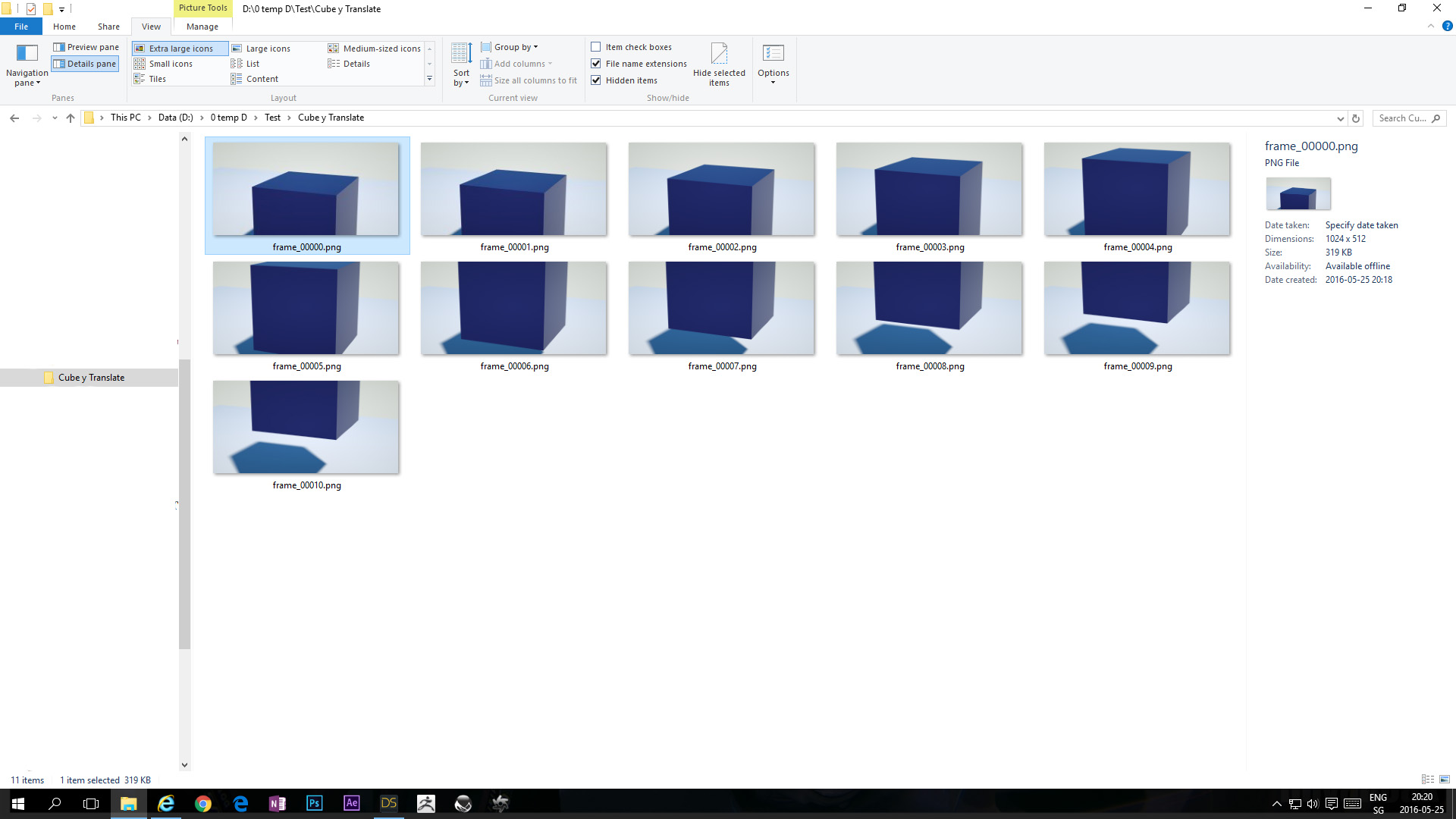

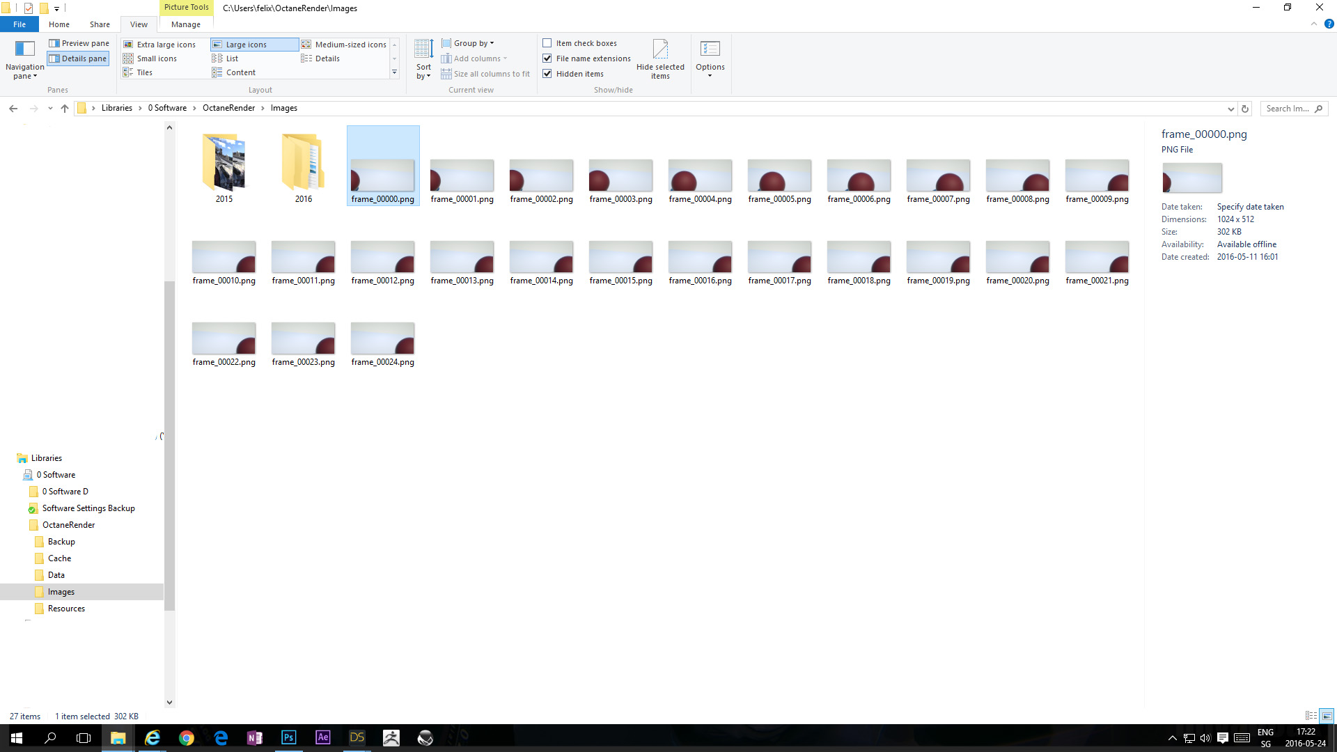

When checking the Windows explorer folder it became obvious that different render dimensions were used
AND
the framing is different than defined:
1024x512

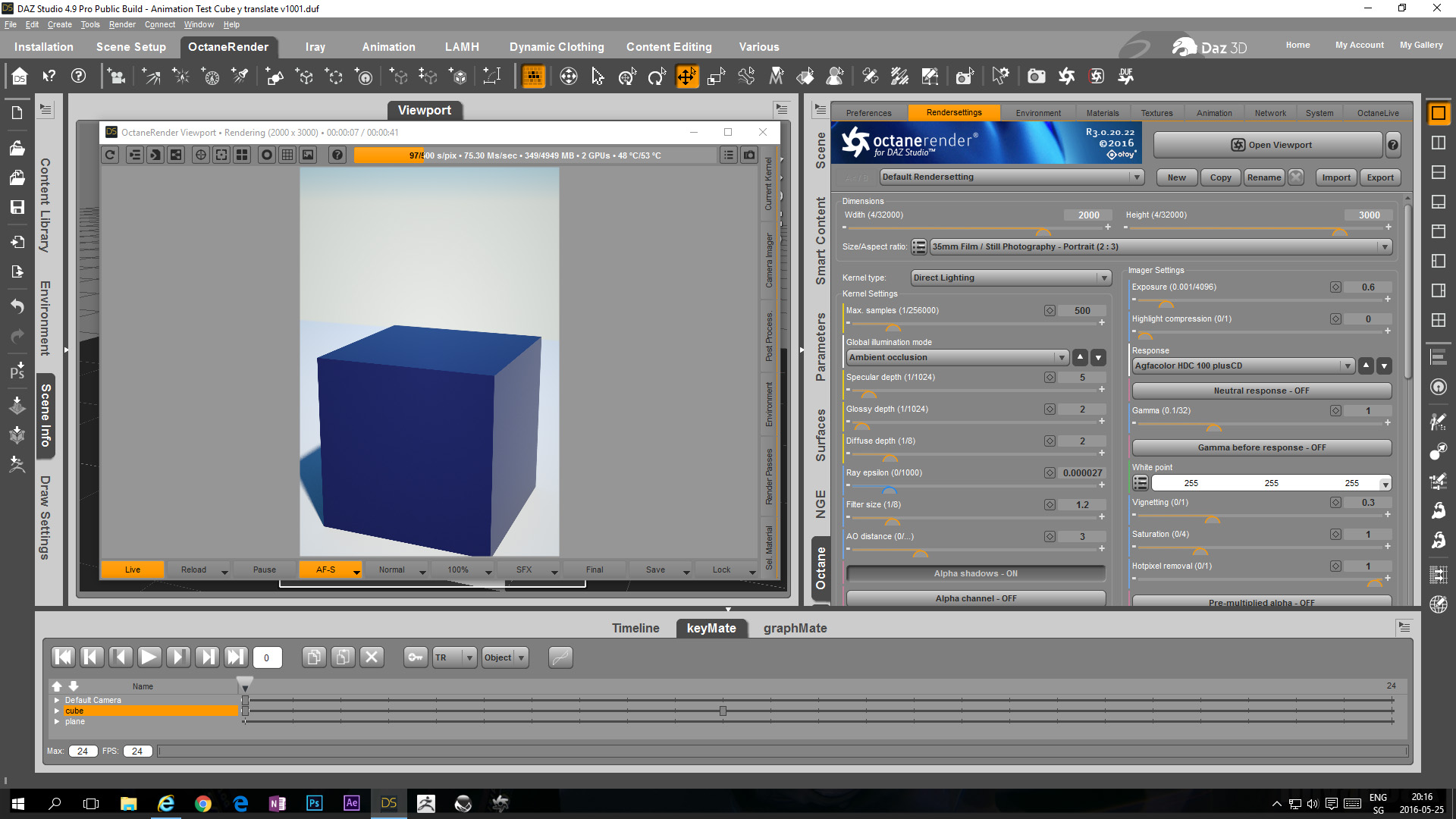

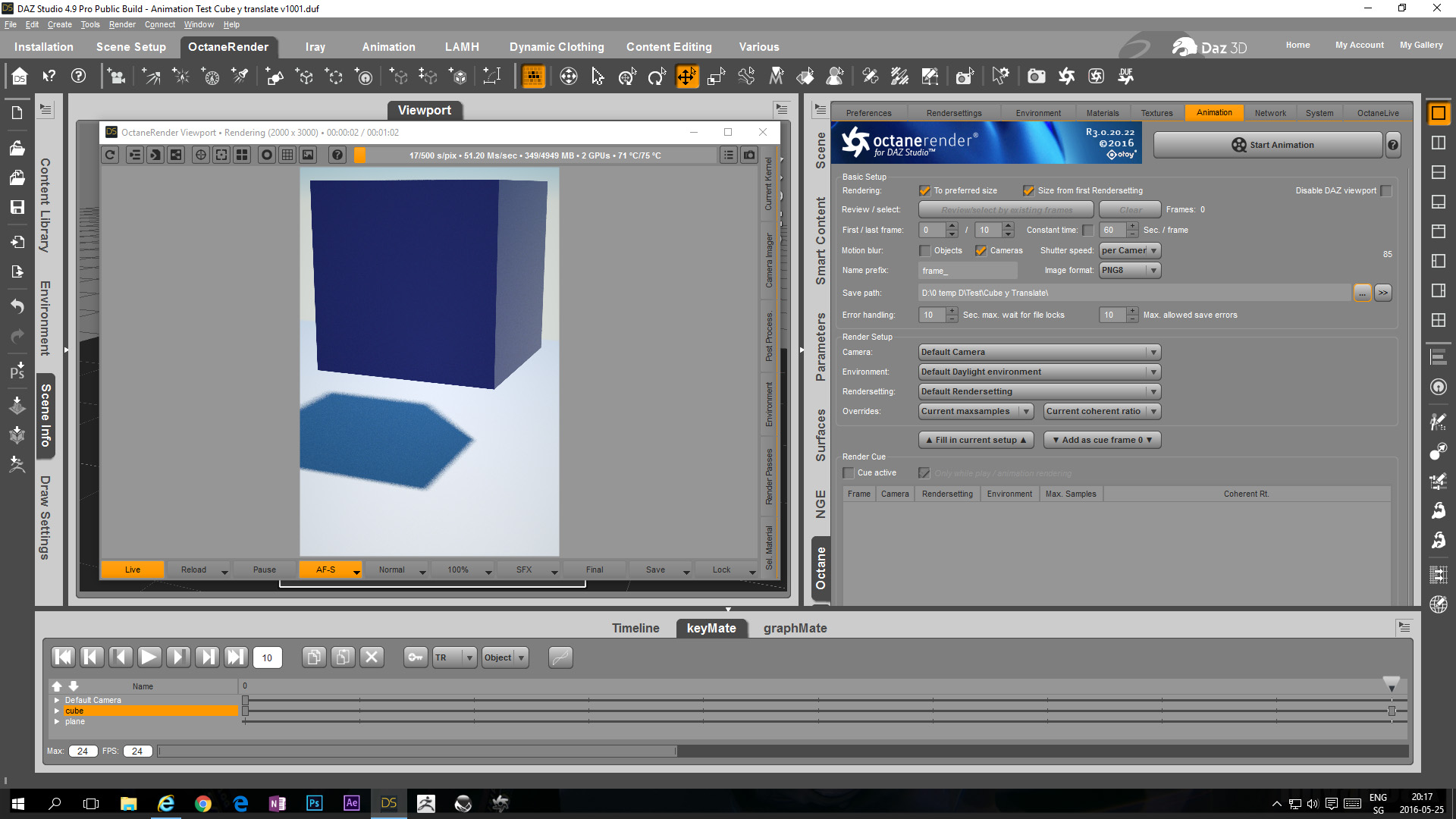

Another day another test scene:
Cube Y Translation
-> To narrow it down what exactly is going on I made a test with
2x3 aspect ratio with
Dimension 2000x3000
Cube Position Frame 1
Cube Position Frame 10

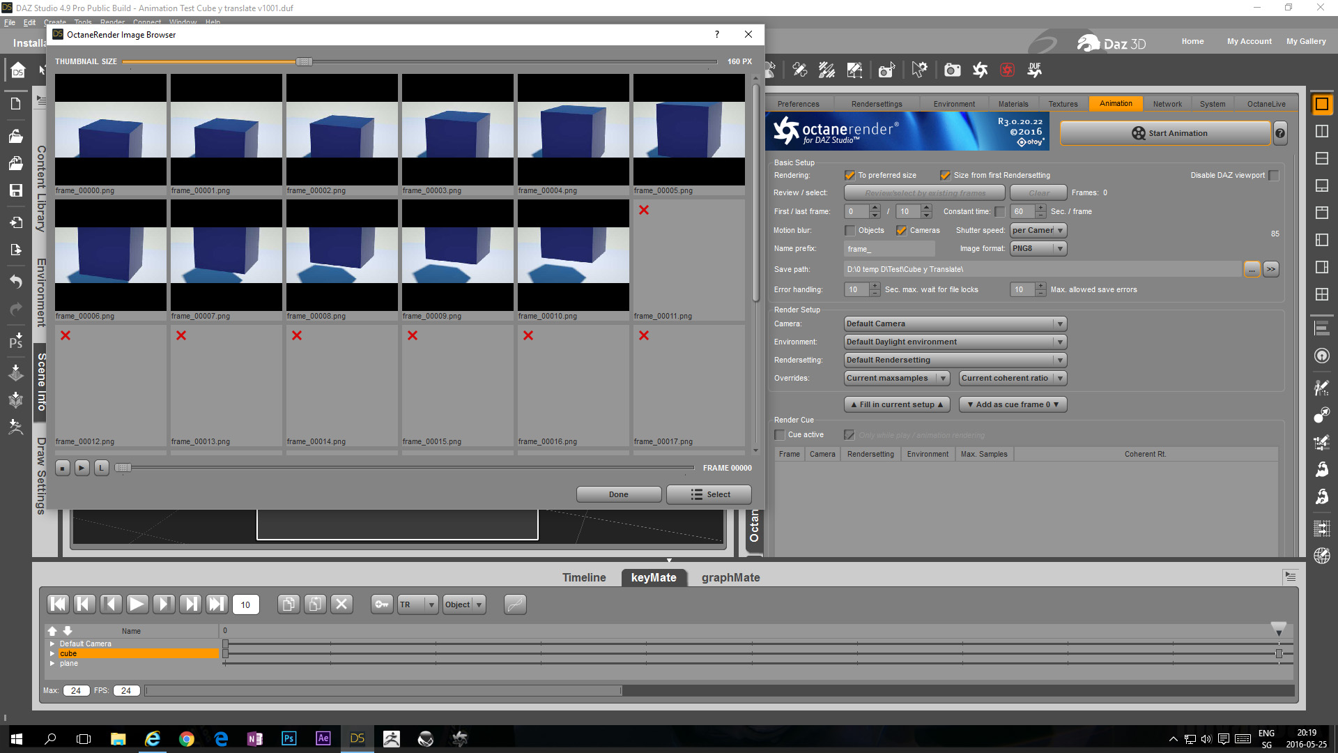

AND
1024x512
Based on the previous tests it seems that
For animations framing and dimension values are always 1024x512 since build 3.0.20.21
Tested with
Daz Studio Pro BETA - version 4.9.2.67
OcDS 3.0.20.22 - described error happens
OcDS 3.0.15.21 - described error happens
OcDS 3.0.12.20 - error does not happen
-> Bug introduced with build 3.0.15.21
Test scene as .duf in .zip:
Animation Test Cube y translate v1002.zip
(34.14 KiB) Downloaded 317 times
Win 10 Pro 64bit | Rendering: 2 x ASUS GeForce RTX 2080 Ti TURBO | Asus RTX NVLink Bridge 4-Slot | Intel Core i7 5820K | ASUS X99-E WS| 64 GB RAM
FAQ: OctaneRender for DAZ Studio - FAQ link collection
