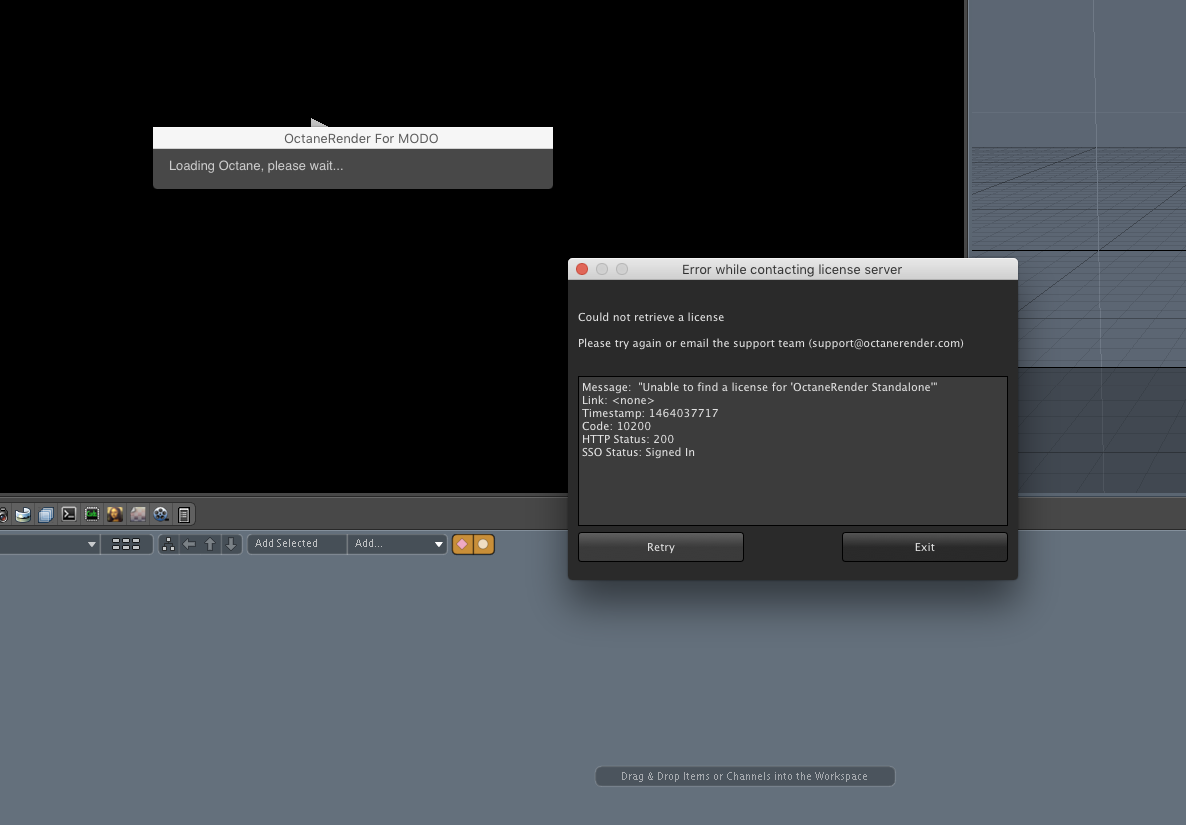

Just upgraded to Octane V3 but I'm having problems with the latest MODO plugin.
I keep getting a error pop-up.
Standalone is activated and working.
Any suggestions?
thx
Ray

macreation
Posts: 8
Joined: Sun Apr 25, 2010 11:22 am
Hey Paul,
Followed the instructions for deactivating V2 and activating V3 and I'm still running into the same issue.
Ray

mojave
Posts: 1411
Joined: Sun Feb 08, 2015 10:35 pm
Hi Ray,
According to our systems, your standalone license is currently activated. Please make sure to deactivate that one too before running the V3 plugin.
Thank you.
