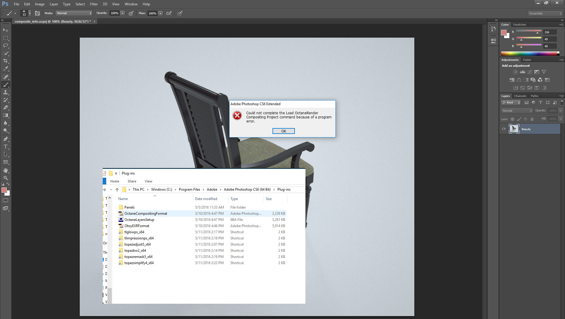

I've downloaded the Octane compositing extension for Windows and added the 3 files per the attached screenshot into Photoshop's plugins, but I get an error after it processes a project from Octane.
I am using Photoshop Extended CS6.
All the files briefly appear as thumbnails in the layers, as they process in Photoshop, but then it reverts to just the beauty pass in the layers panel with the attached error.
There is also a "signatures" xml file in the "META-INF" folder, and a "metainfo" file and "mimetype" file included within the Octane compositing extension, but I don't know where to place those (or if I should) in Photoshop.
Any assistance would be much appreciated.

I posted my message below on your updated plugin thread as well, but please note that I'm still receiving errors (although making a small bit of improvement):
Thanks for the update to the Photoshop plugin.
I installed this with the extension manager for CS6 (Windows), however I still get the same error message per my screenshot before.
This time, all layers stay in place after the plugin runs, but the previous error message per my prior post still pops up.
Also, I get the same error message ("could not complete "the" command because of a program error") when I attempt to run the "Setup Octane render layers" command.
Any additional help would be most appreciated!

Thank you Nathan,Ndawg wrote:Here's the compositing file.
I sent the zip exr file to you via private message.
Thank you,
Nathan
I confirm I can reproduce this on CS6 (on CC works fine in case you want to try). We'll fix it ASAP and release a new version.
Sorry for the inconvenience.
