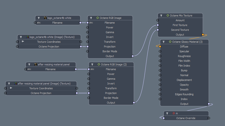

Somthing like this, but I can not connect them...

I think you could just plugin the two images into an Octane Mix node.

Hi Paul,
Can mix texture randomly place different textures on different meshes/objects in the same material? If so, that's exactly what I am looking for.
Unfortunately not. However there is a random color node, which will randomly color instances in an Octane Scatter node (ie. from a Mesh Instance or a Replicator). So if for example the windows need to be different lightnesses, make them generated from a Replicator and the random color node should work. See Random Color Texture at https://docs.otoy.com/#60Octane%202.0%20Features
