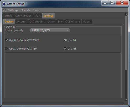

When you bought it? Without testing with demo? There is nothing to fix. Gpu will be very busy with rendering if you have expensive scenes with highres. You can add second cheaper gpu for desktop.
Just be sure that you have "use priority" + PRIORITY_LOW.

aoktar wrote:When you bought it? Without testing with demo? There is nothing to fix. Gpu will be very busy with rendering if you have expensive scenes with highres. You can add second cheaper gpu for desktop.

You may use i think. Connect your monitor to 610. Sorry to hear you did a personal mistake. Try to ask for a refund if you bought it in a few days. But mostly it's not possible to refund else of faulty payments, etc... Here i can't see any defective situation for product and we have a demo to try before buying. Anyway if you still wish to do that i'll advice for a refunding if it's possible. Good luck on your life!

If you have an i7 processor, that comes with integrated graphics. So for Octane, you can stick your monitor into the mobo output, and the rest of windows will work off the integrated graphics while Octane chews on the Nvidia. I have a single Titan X in my machine with this setup and couldn't be happier.
