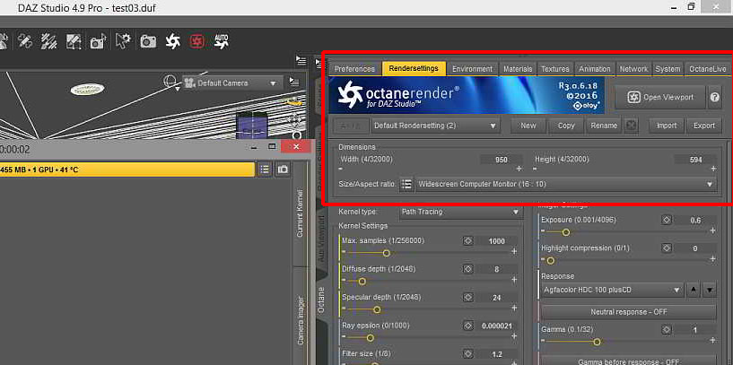

I created a scene and when I'm opening the viewport it only renders 4x4 pixels no matter what render dimensions I have set.
I mean, that's nice and fast, but not very helpful.
The viewport only changes to the correct dimensions when I switch to "Final", but then then I'm no longer able to pick objects or surfaces from the scene:
Am I missing something?

Paul, I did that :)
As you can see in the screen shot the dimension is set to 950x594.
I tried other values and aspect ratios as well, with no change.
The dimensions do apply when I click on the "Final" button, but not in the preview, here they stay at 4x4.
Uwe.
Sorry - I can't see that from the screenshot. Can you include the Render Settings in the screenshot pls? Also - you haven't included the info requested in the "releases" threads - which would be very useful pls.

Sorry, so you are not talking about these: :?:
Render settings
Render settings
Are there other render settings? If so, where?
Thanks 0- that's what I was after. Firefox was cutting off the right side of your image in the post above.
