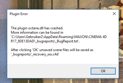

Octane keeps crashing multiple times a day. Currently I'm mostly busy with materials/textures. Not sure if that is causing the crash though.
I send the error to Maxon, but they said it's Octane causing the crash.
I have included a screenshot of the error and the txt log file.
The plugin octane.dll has crashed error

Ok thanks, there is an error about Octane. But this is not enough to say somethings. If you read release topics, you'll see this requests on bug reports. I'm writing again.
1-What's your plugin version, OS, C4D version, nvidia driver?
2-How this happens?
3-What's last operations? Can you describe me some exact steps to reproduces? Is it belong to some specific scene?
4-Do you have more bugreport files?

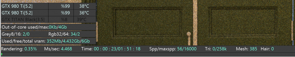

Are you sure that's not about low free VRAM?

Are you sure that's not about low free VRAM?[/quote]
Yes I'm sure. See attachment screenshot.
