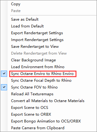

Hi Paul,
Yes,I need this OctaneScript command. If you have sometime, I wish you to enhance the OctaneChangePinValue command for this function.
And the OctaneChangePinValue [pin name] [pin value] command have all value for Modify internal parameters will very power. Now some internal parameters cant support. Can you make it? :D
like this:
I need to set it every time. I hope one script command for solve this.
sorry for my english.
Thanks for your help.
Alxen
