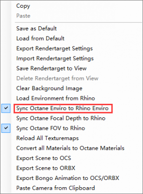

like this: I need to set it every time. I hope one script command for solve this.
