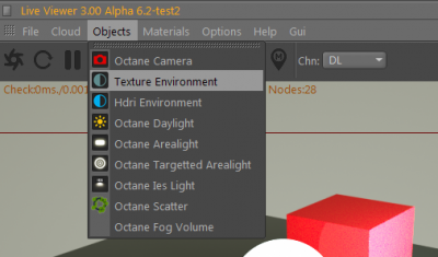

Btw, i advice to watch a few video tutorials before answer your questions. Anyway you should create texture environment to give dark environment. And increase power in your emission textures.
