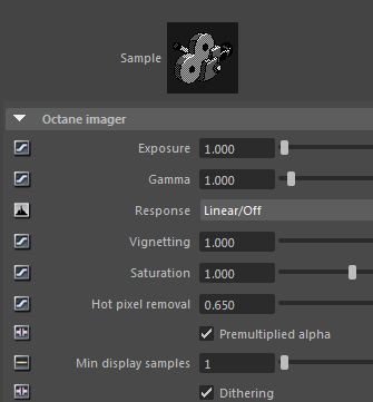

also, when rendering with alpha channel, it doesn't look clean around the edges of the object.

Don't know for the low GPU power but for the alpha channel it could just be a straight alpha, I think Maya default to straight, if you want premul alpha make sure "premultiplied aplha" is enable in the camera setting.
