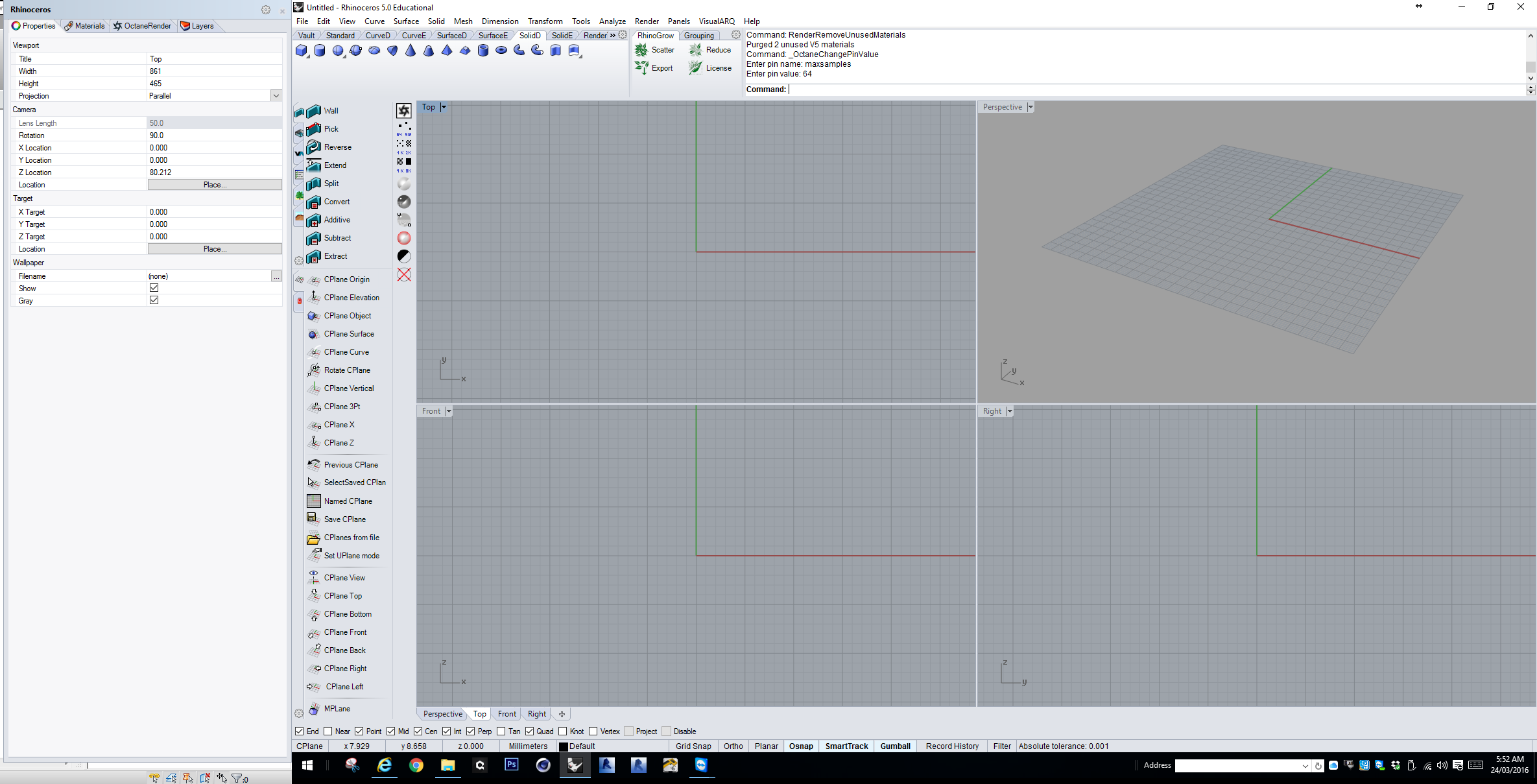

Certainly not complaining; I really like it!!! I'll post my setup, I don't use the sidebar in the conventional way; but I did place it roughly as you suggested (right?) :)
EDIT: setup below; the properties, mats, octane, layers are on the second screen (cropped the rest off..)
