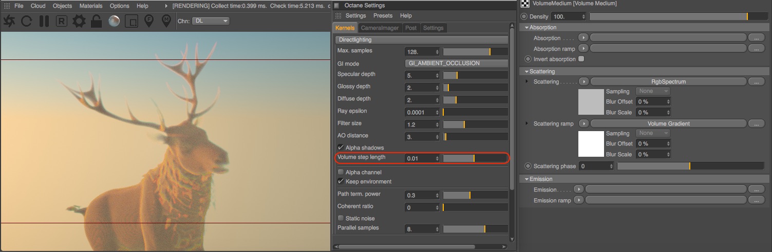

Hi Yam,
here is my attempt with scattering only and a Volume step length of 0.01 in the kernel settings:
stage_b.c4d.zip
(48.01 KiB) Downloaded 126 times
ciao beppe

Thanks folks!
This is what i was missing
