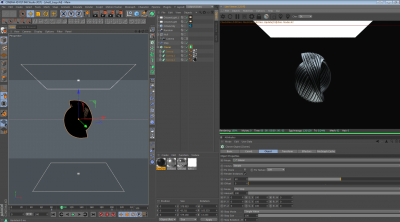

Hi arleksey,

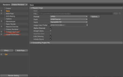

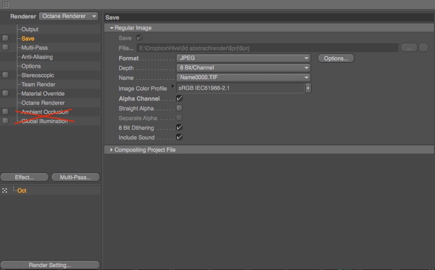

please, copy and paste all the scene elements in a new fresh scene because your render settings are messing up with c4d native options mixed with octane :roll:

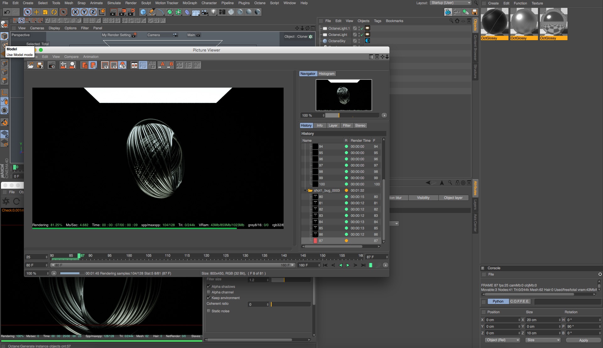

You must see the green bar + info if octane is rendering correctly inside Picture Viewer.
Next time, is better to create a newer render setting octane specific if you already have a c4d render setting active ;)

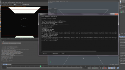

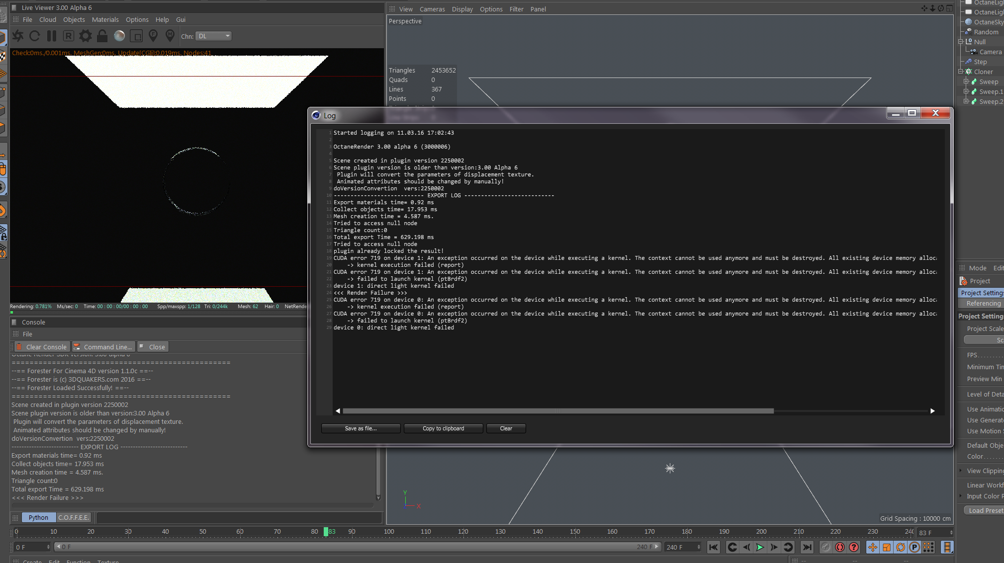

I assume there is some many badly wrong usages for octane. See image for crash output.
To make the objects zero sized as you make circle=0 radius can cause this. It generates a lot of points at same coordinate and can crash the renderer's geometry engine or driver i suppose.
Event it happens on LV while going to between 80-90 frames.
I'm checking more.....
