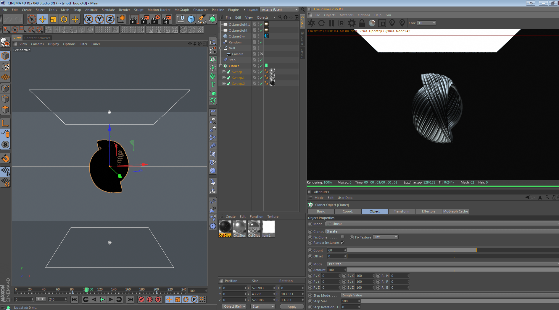

very simple scene with rings and clonner, livepreview is working well, but Octane crushed everytime i try to render it.
the scene is ready, so everybody just hit [RENDER}
PS. i think that the problem for Octane is that a lot of clones are in one point and overlapping. Check attached file in message below with solved word

semi solved: setting clonner count to lower number (20 for example) everything begins to work.
i calculated: 60 clones of sweep produce about 12mln polygons, ofcourse this is to musch, but in clonner "render instances" is ON, but octane seems to ignore it and making "true" geometry

solved: i fixed by animating cloner quantity, so geometry doesn`t mixed in one point

you are rendering wrong time, try to start render 70 to 80 frame in file you`ve attached
everything goes great after clonns start to rotate
Wait! There is a crash on Renderer side, propably due driver.
i tried on five different machines with different software (drivers) and hardware. No one could render this scene.aoktar wrote:Wait! There is a crash on Renderer side, propably due driver.
check the fix file i`ve attached few messages upper, that works great with 60 clones
I assume there is some many badly wrong usages for octane. See image for crash output.
To make the objects zero sized as you make circle=0 radius can cause this. It generates a lot of points at same coordinate and can crash the renderer's geometry engine or driver i suppose.
