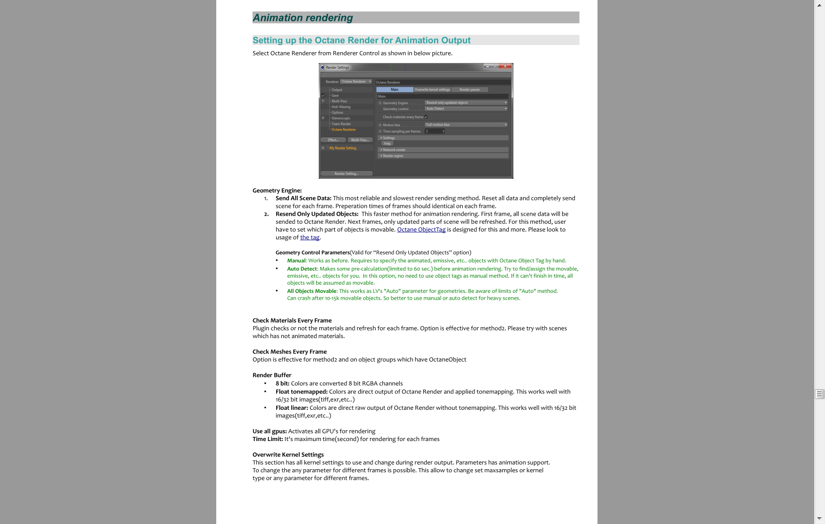

please explain better with more helpful info. What the times are you talking? Did you tried with default options? Have you read this page in manual?
