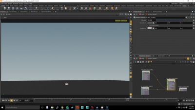

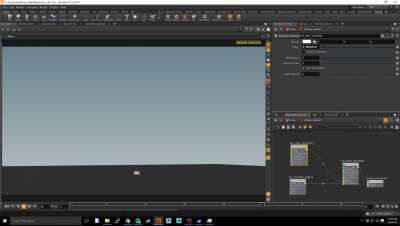

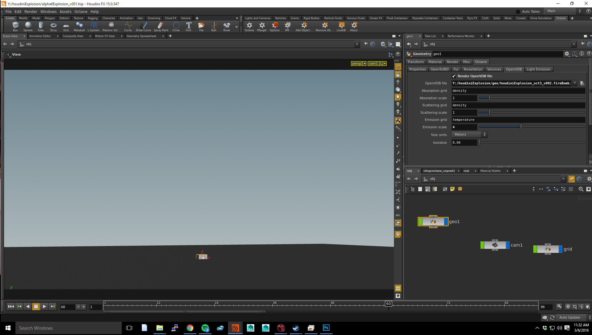

I used Houdini to make the VDBs from volumes/fluids and then the latest version of 3.0 alpha to render them. I'll post screenshots as well as my scene files below!

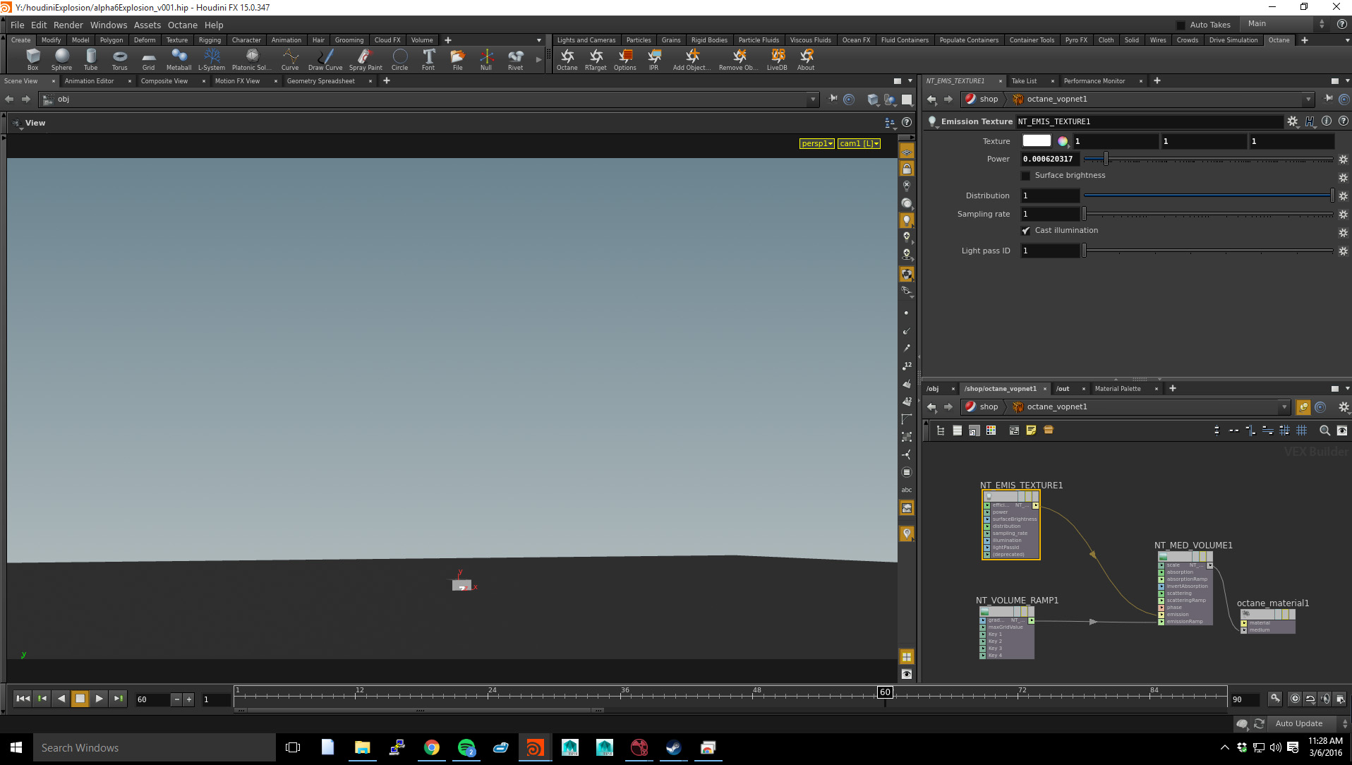

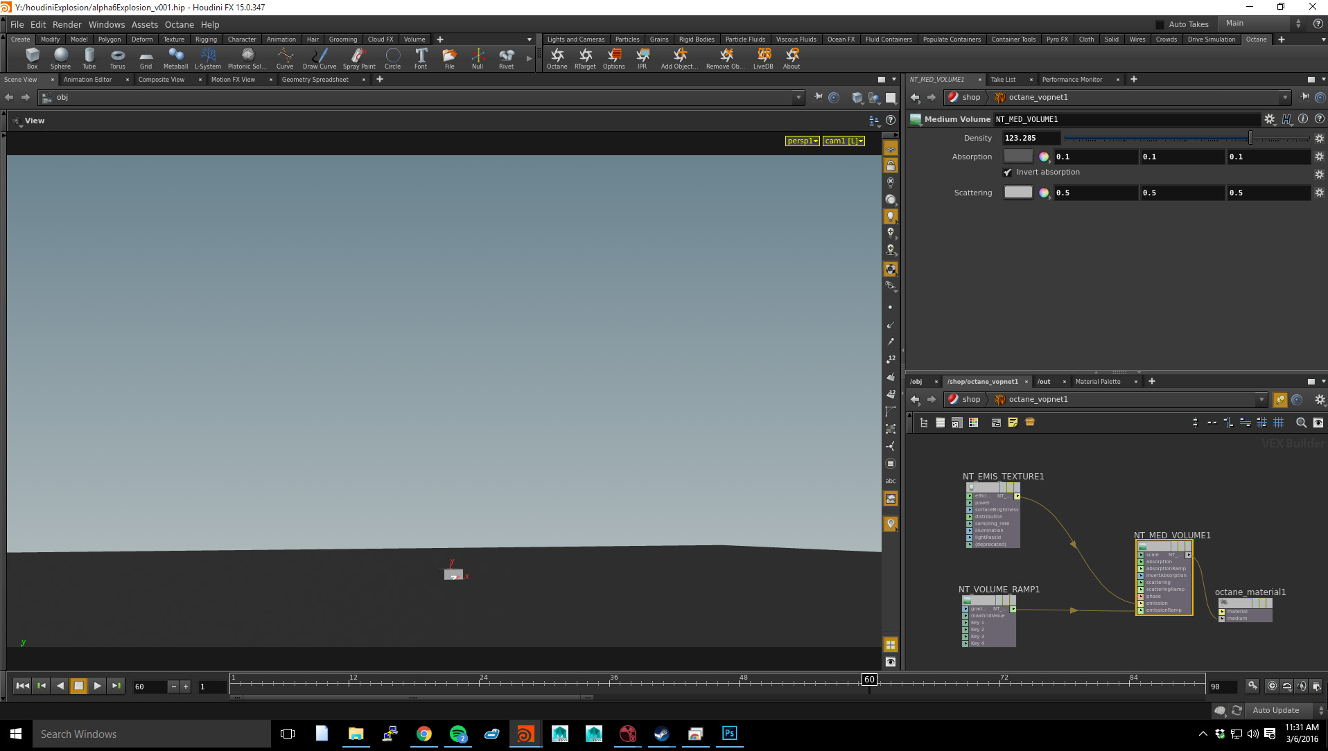

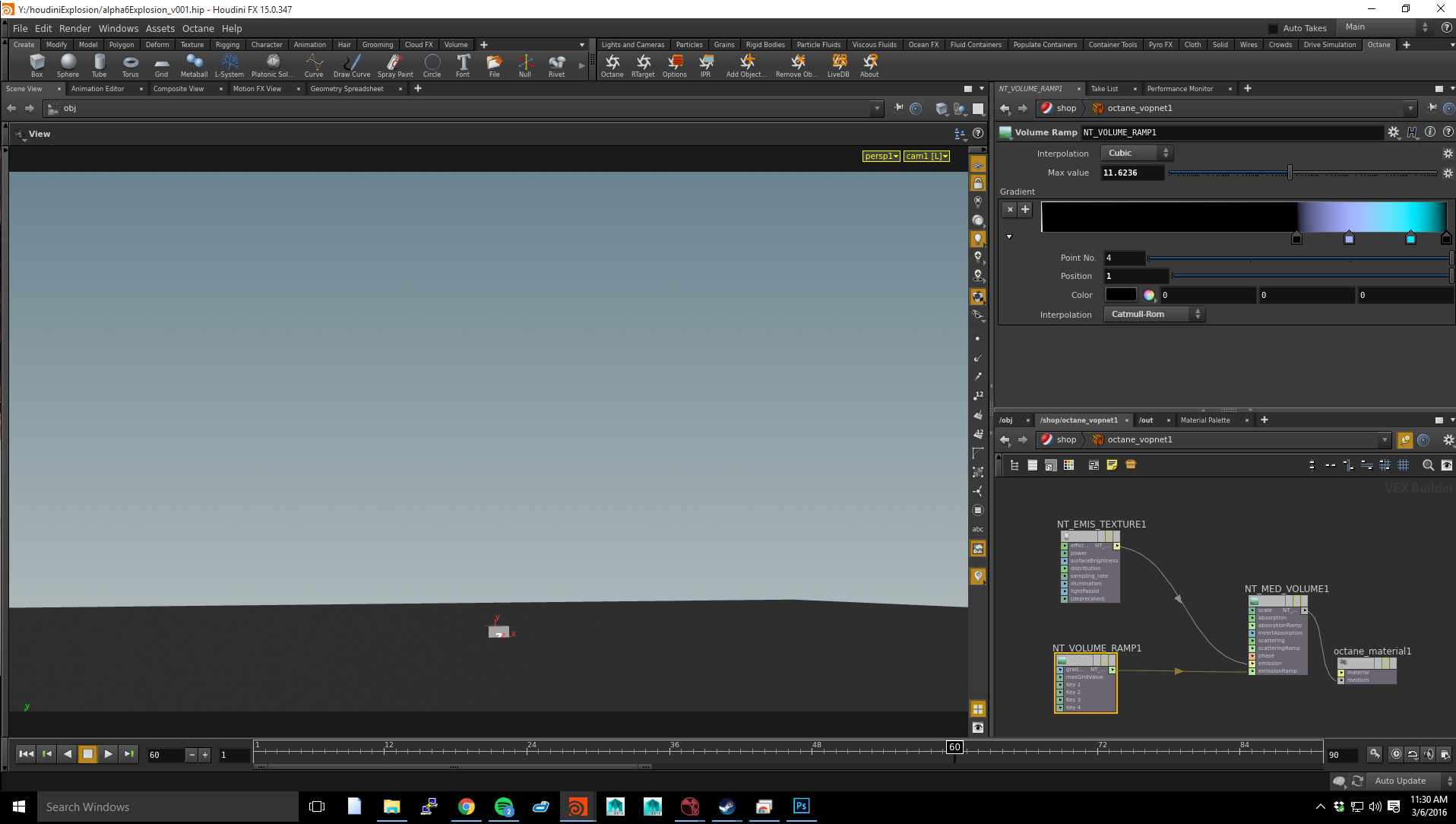

The trick I used was to set the volume ramp to RGB colors. So left is red middle green and right blue while keeping the emission node white. Then I adjusted the "max volume" slider till I see all 3 colors where you want them within the volume. Once that done you can start placing the colors you want with an idea of how they'll re-map. Its crazy freakin cool how fast it resolves the volume. RNDing a look for fluids is just easy with octane which is just incredible...
For this scene I had the volume step length set to 1.
Houdini scene file as well as VDBs - https://www.dropbox.com/sh/kicxgcu2sfyv ... fVUAa?dl=0
The VDBs, (48 frames), may still be uploading. its about 3.2 gigs
I also placed frame 48 by itself so you guys can start playing now!
