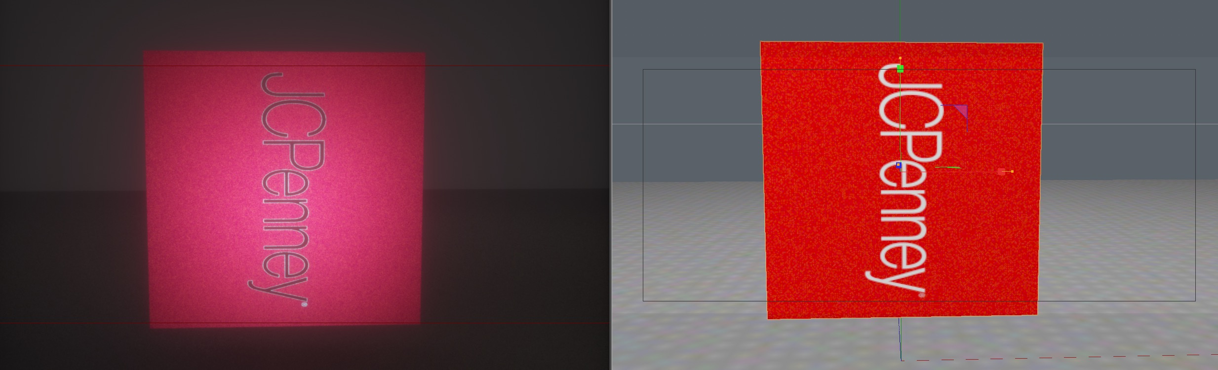

Hey guys, I'm about two weeks into Octane and love it so far.
One quick technique I was hoping to figure out was how to create an accurate backlit graphic look?
Normally I would just create a illuminated material in Cinema, but I think Octane can get a more accurate look.
I took a look at the rice paper lamp that someone posted, but I had issue transmitting accurate colors.
I wasn't sure if I should be using the transmission from diffuse material or the medium from the specular material.
Any point in the right direction would be much appreciated!
Desired look.
Desired look.

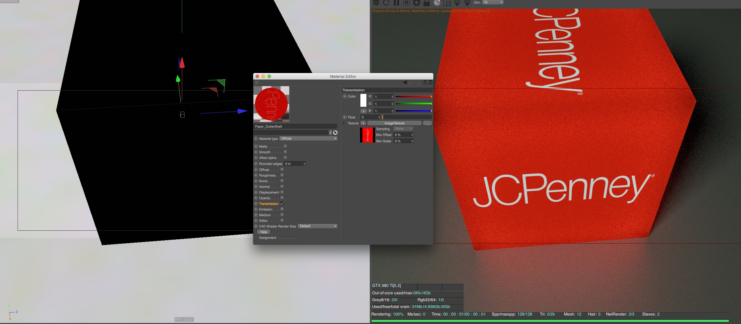

It seemed to work as long as I had nothing in the Diffuse channel. Not the route I wanted to take, but it will work.

this is faster way that causing extra calculation due backlight. Add or multiply by a gradient,etc... to obtain better look.
natemac00
Posts: 251
Joined: Mon Feb 22, 2016 3:45 pm
aoktar wrote:this is faster way that causing extra calculation due backlight. Add or multiply by a gradient,etc... to obtain better look.
But I lose some of the detail in the image (when using something like a photo not this) when I texture the emission channel. Everything gets blown out pretty easy as I move up.
