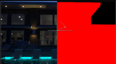

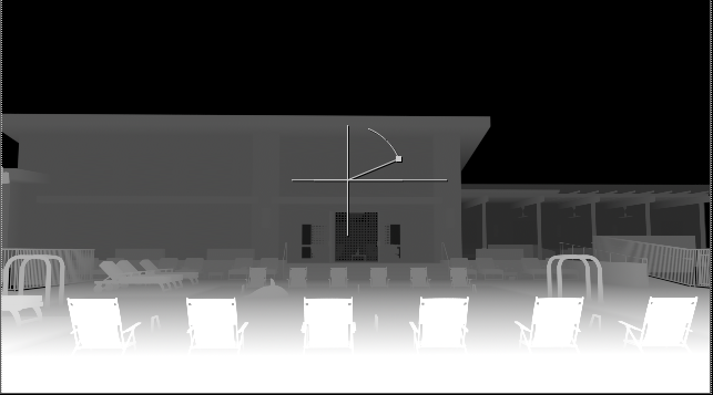

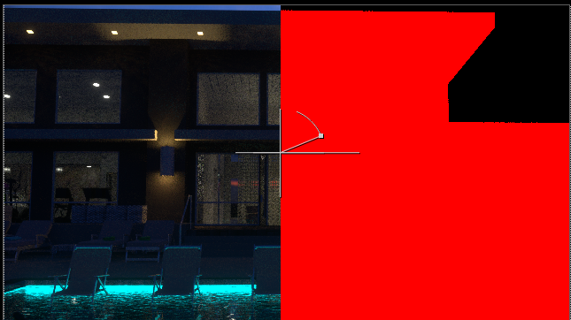

I am currently using Octane 3 alpha 2, on this same version in the past I have rendered z-depth with no problems. On screen it shows the correct pass but when I output the file to either a layered exr or individual files I get no information in the zdepth. I have a work around for nuke that works well enough using the position pass and a camera, but I would like to be able to just use a z-depth pass. Anybody have ideas as to what is happening?

Z-depth is saved as a single channel pass in multi-layer EXR files (we changed this behavior a couple of weeks ago). So in Nuke you would need to extract the Z_depth.Y channel instead of RGB channels. I tested this today and I can still get the correct values in Nuke.
