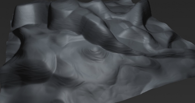

does it possible use displacement 3 times in one mix material?
I found a web page
http://motionworks.net/pause-fest-2016-motion-response/
in his video show this node,but I didn't succeed

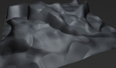

It is only the displacement map in the master Mix material which takes effect. The 2 displacement maps he has in the two first materials have no effect on the Mix material.
