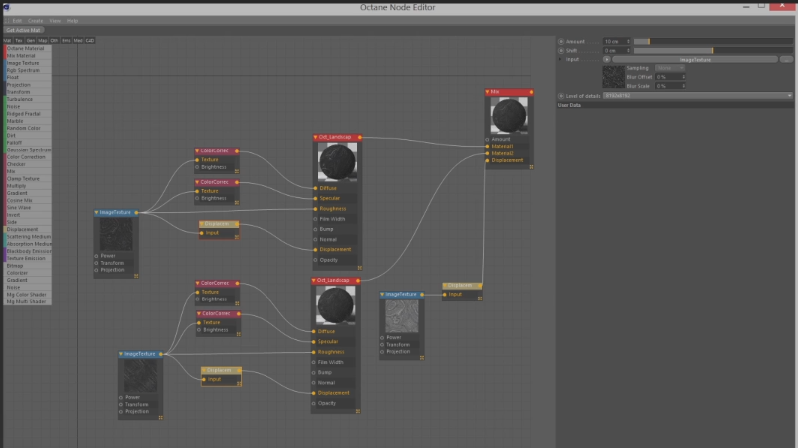

does it possible use displacement 3 times in one mix material?
I found a web page
http://motionworks.net/pause-fest-2016-motion-response/
in his video show this node,but I didn't succeed
use displacement 3 times in mix material
It is only the displacement map in the master Mix material which takes effect. The 2 displacement maps he has in the two first materials have no effect on the Mix material.

A workaround for this could be using the cinema 4d displacement modifier for the larger scale details and use the displacement material on top. I use this when making grass. Still, this is only two layers of displacement and you have to pretesselate.
