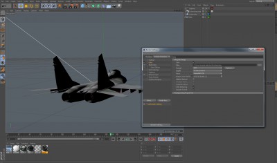

Hi, I´m triing to render out my image in RPF format within C4D R16, because I would like to add a DOF in AE trough 3D channel extract effect, but I only get a black or white screen, when I´m triing to adjust the Z-depth, even with the smallest value like "0,1".
So my question is..am I doing something wrong , or Octane doesnt support RPF format, for extracting a DOF in AE.?
this is what I´m triing to achive : https://www.youtube.com/watch?v=agLHxkKPDRM
Thanks.
M.
my scene
my scene
Posts: 16068
Location: Türkiye
There is ways. "Octane is not support any format" that's senseless. First, you should use render passes section. This is default way to extract any passes. There is no RPF, but available in C4D multipass save section. Also if you use linear/32/16 bit, z-depth pass will have values bigger than 1.0. This giving white in pshop, etc.. It requires some normalisation in edit software. Or you can switch to tonemapped pass output. This normalizes this pixels to be between 0-1.
