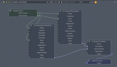

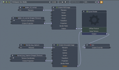

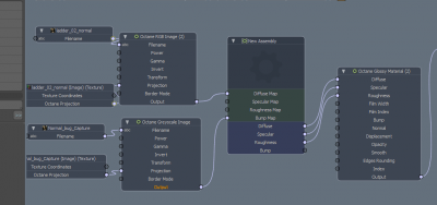

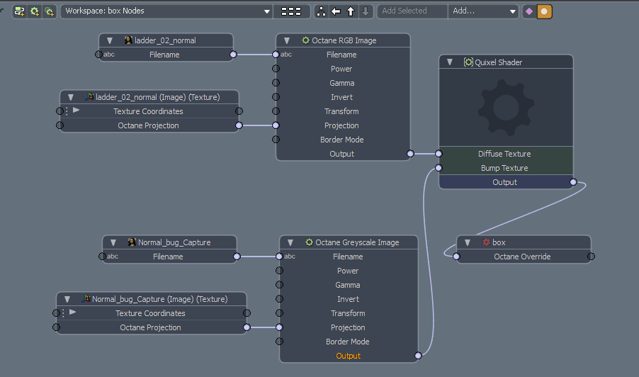

I couldn't find the Quixel shader in the LiveDb - if you can tell me where it is I can be more specific. But if it's a Mix Material, you can do this as per the screenshots below. Keep in mind there is not pin compatibility validation within the sub-assembly, so you can make illegal connections.
