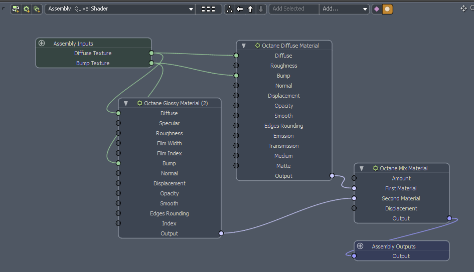

Also - if you are rebuilding the Quixel shader - are you aware that you can create a sub-assemby with inputs being the texturemaps and outputs being the to each pin in the final material node. For example - the sub-assembly "New Assembly" could contain all the Quixel shader nodes - and then you simply plugin in the texturemaps to the inputs.

I was looking for texture in and material out nodes like in standalone but didn't see them. I guess I will need to learn how sub assemblies are done in Modo. I haven't used the Modo schematic much.
I couldn't find the Quixel shader in the LiveDb - if you can tell me where it is I can be more specific. But if it's a Mix Material, you can do this as per the screenshots below. Keep in mind there is not pin compatibility validation within the sub-assembly, so you can make illegal connections.
