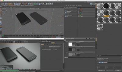

I'm testing the demo of Octane in C4D.
Everything works fine. At the moment I'm testing a scene of an Iphone, like this tutorial (https://www.youtube.com/watch?v=hy9AkLTLmOQ)
But when I, as example, rotating the scene, it takes longer than I expected in the Live Viewer. See screenshot
https://www.dropbox.com/s/w5m5bc7iggv6p ... e.jpg?dl=0
I'm worried if my settings in the renderer & Octane settings are wrong. Do I have to change the Render Priority?
Does anyone have any remarks about this?
Thanks in advance,
Tim

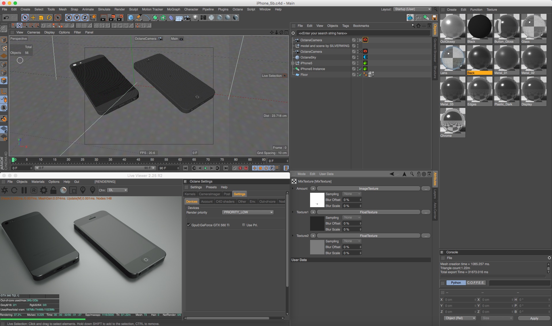

Hi Tim,
render priority must be active for all the GPUs with a monitor attached, if you have only the GTX 980 ti on your system, then the render priority must be active.

Hi Beppe,
Thanks for the reply. So, what's the right render priority? Is it LOW or HIGH?

The priority should be set at Low while you are editing the scene and High when you are only rendering ;)
Wow, a model from Raphael, great :)
There were some missing textures and a Vray node, could you try with the attached modified version, please?
It's super fast here in both, real time navigation and rendering :roll:
