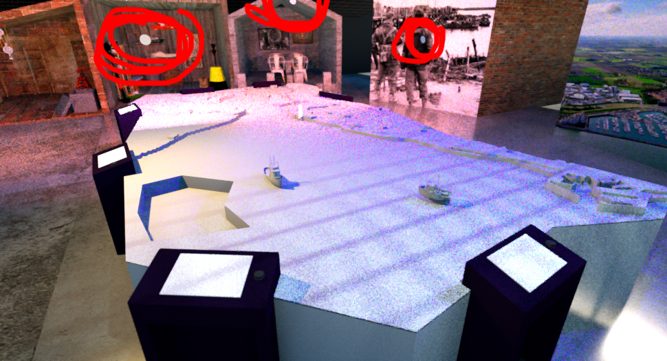

Does anyone have a good light workflow for octane in rhino? How do you get rid of the lightobjects in the final render, while keeping the light they're emitting.
In the attached image are the red circled around objects that are the visible light objects. I just want to have the light.. not the objects in the renders.
Thanks!
Friso
The red circled objects are the visible light objects. I just want to have the light..

Alright. I found the solution.
set opacity to zero on a light object. it will still emit light. See attachment.

You can set your light object to live geometry and uncheck "visible to camera" ;)
