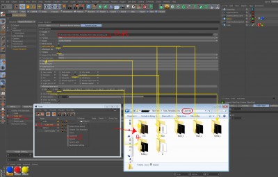

Hi aoktar,
my workflow was:
1. For any take (red Number 1 in the picture) in the take system you have to setup new render settings. Left side (red number 2 in the picture)
The folder for the Renderpasses has to be manually setup under "File" like the red path indicated in the picture view.
2. Also assign the correct render setting by the pull down menue in the take system (red Number 3 in the picture)
3. Now you can render all marked takes and you can go to sleep.
This is my solution without "token". I think the token system can't read the passes provided by Octane.
This is what's missing.
I hope you can find some solutions. This would be great because it's a fantastic tool, a big big time saver
and very versitale on any daily job.
Best regards
Petesand
