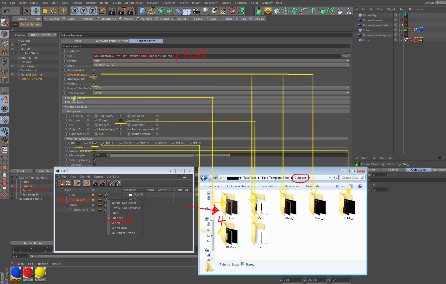

Hi guys,
How to render Octane RenderPasses incl. token with the take system? I can't figure it out how it works.
The only way i discovered was to make new render settings for the corresponding take name in the take system,
but this is without any token.
But there is no way to simplify the renderpasses process with token.
My question is:
IS THERE A WAY TO RENDER OCTANE RENDERPASSES WITH TOKEN?
IF SO PLEASE TELL ME HOW TO DO.
I'm looking forward to see any solutions. I count of you guys.
Thanks in advance

Takes system has not been supported officially until now. I haven't spent any special attention for this. It's just a good luck if somethings worked on you. I'm currently making some changes to bring a support. But I didn't checked parameters of passes. If you put a few images to describe better I'll appreciate it.

Hi aoktar,
my workflow was:
1. For any take (red Number 1 in the picture) in the take system you have to setup new render settings. Left side (red number 2 in the picture)
The folder for the Renderpasses has to be manually setup under "File" like the red path indicated in the picture view.
2. Also assign the correct render setting by the pull down menue in the take system (red Number 3 in the picture)
3. Now you can render all marked takes and you can go to sleep.
This is my solution without "token". I think the token system can't read the passes provided by Octane.
This is what's missing.
I hope you can find some solutions. This would be great because it's a fantastic tool, a big big time saver
and very versitale on any daily job.
Best regards
Petesand
