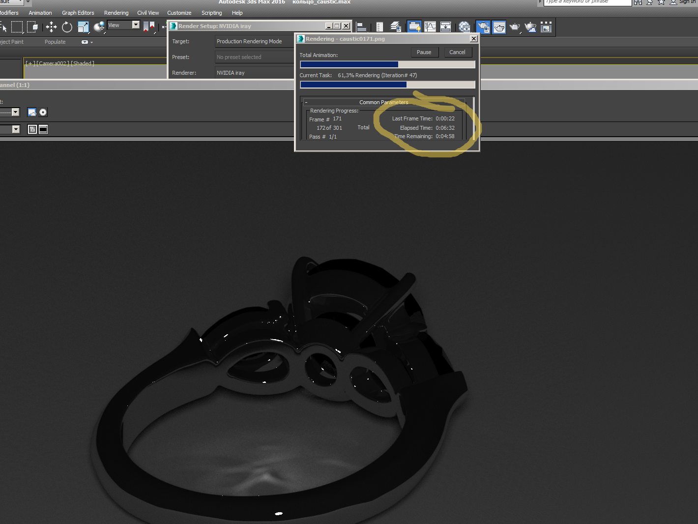

Good day ... very very slowly ... and is considered to be caustic in animation sometimes it is not justified to use. Tell me do you plan to manufacture fake caustics or optimizing for animation . THANK you ! Now when rendering jewelry I use caustic i-ray visualization frame HD = 25 seconds/// at PMC, it takes 10 to 25 minutes = I understand that this caustic is physically correct but I don't have time to wait for Octane Render will process light. ( 3D max / 2016 // 2.15 v)
as you can see I need to add caustic . and I can't generate it through PMC slowly

picture fake caustic IRAY =25 FULL HD !!!!
2016-01-20 17-09-34 Camera002, frame 171, Display Gamma  2,2, RGBA Color 32 Bits Channel (1 1).png

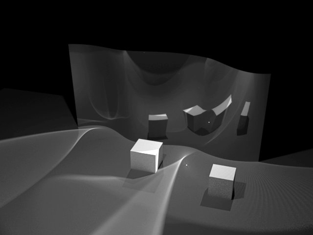

The Iray renderer does not allow to do this
I think it was because this particular algorithm is so fast because the beam is cut immediately after 1 reflection
( 3D max 2016 standart IRAY )

Goldisart wrote:I waited a long time but I never saw the secondary reflection in the mirror caustics

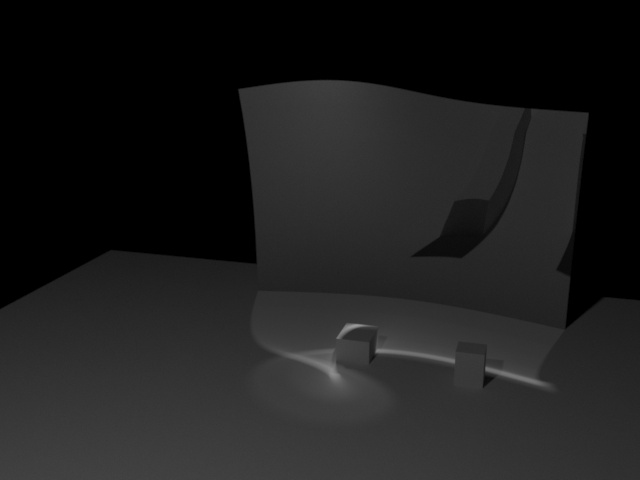

I made a similar quick test scene as you had.
Standard Iray that comes with Max 2016.
I DO get caustics in reflections.
