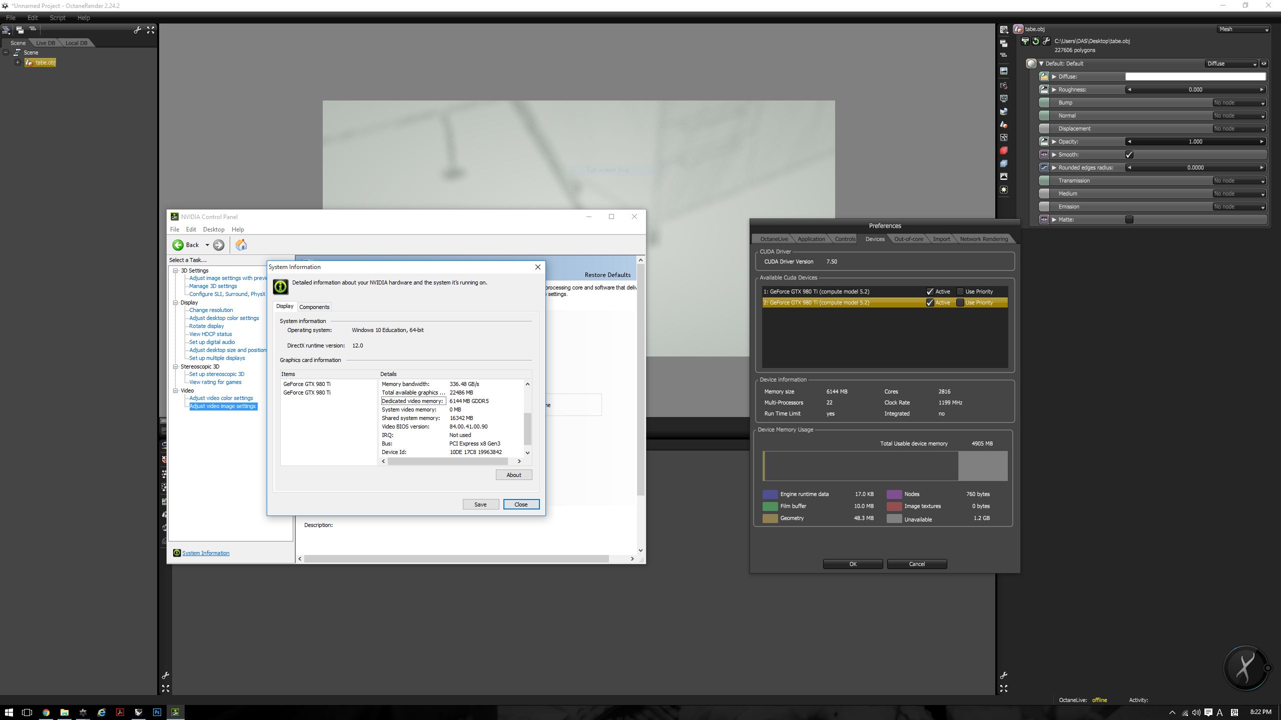

Hi Everyone,
I'm seeing a 1.2GB memory unavailable on my device preferences in Octane Standalone. I am using two 980 TI Hybrid GPUS with my Apple Cinema 27 inch display powering from the integrated graphics (Intel 530) from Z170 Deluxe / i7 6700k cpu.
Will I not be able to utilize all 6gb of my 980 ti's memory?
Any help will be much appreciated!!!
Win 10 64Bit | Geforce GTX 980 TI HYBRID x 2 | i7 6700K | 32GB
Phantom107
Posts: 686
Joined: Tue Jul 24, 2012 11:31 am
Location: The Netherlands
The OS and your open programs are eating it up. If you just enabled GPU number 2, I bet you will be able to use the full 6 GB. At least this is my experience on my Windows machine with multiple 980 ti.

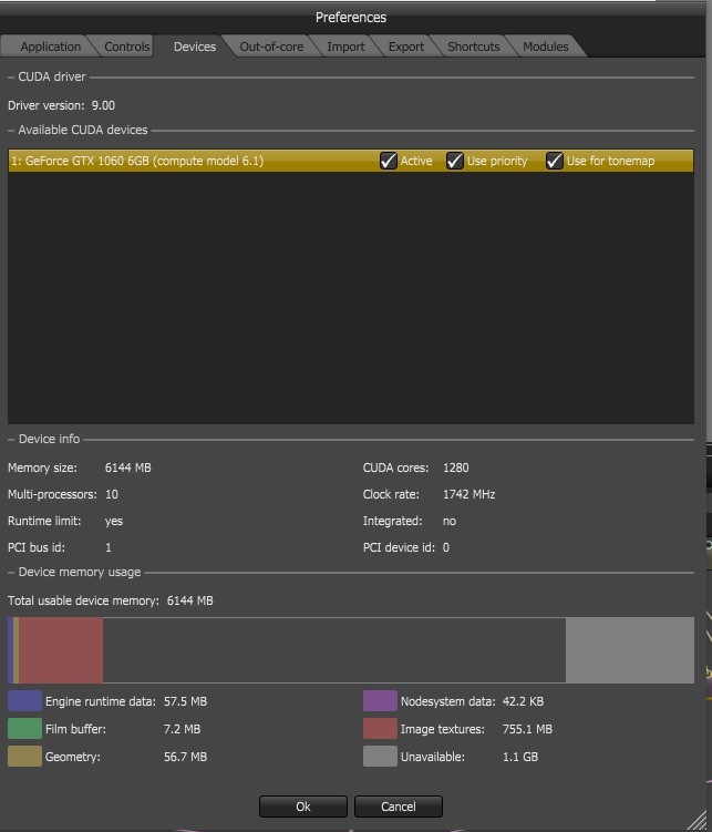

I have the same issue using a GTX 1060 6GB on Windwos 10. Does anybody know what is it due to?

I attach a screenshot. It's 1.1 Gb unavailable.
I hope windows10 solve this problem soon.
Posts: 10575
Hi leo64,
it seems that everything is in order, due to connected monitor + Win 10, you are losing 1.1GB of VRAM.
Win 7/8, Mac Os X, and Linux do not have this issue.
ciao beppe

I dont have my monitor connected to my Graphic card but motherboard.
Posts: 10575
Hi leo64,
if your GPU is not connected to any monitor, you should untick the Priority option.
Win 10 sucks ~20% of VRAM for any GPU in the system.
