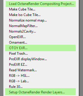

Hi All,
EDIT: Funk has explained below how to install on CS6 and earlier. I had tried already but without success. following his method I now have plugins working on CS6.
Note: it also seems to work with the OctaneCompositingFormat.8bi, OctaneLayersSetup.8ba and OtoyEXRFormat.8bi files&* in the plugin parent folder on my CS6 system
ie. C:\Program Files\Adobe\Adobe Photoshop CS6 (64 Bit)\Plugins\
*the files from the archive as explained by funk
